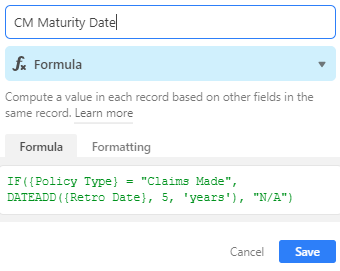

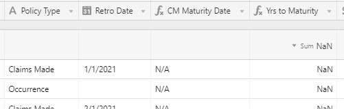

I’m trying to write a simple IF statement in the CM Maturity Date column comparing the Policy Type field and outputting either a DATEADD function, if “Claims Made”, or a text string (“N/A”) if “Occurrence”:
This is the formula that I currently have in CM Maturity Date that results in the above screen cap:
IF({Policy Type} = ‘Claims Made’, DATEADD({Retro Date}, 5, ‘year’), “N/A”)
For the Claims Made policy type, it should have added 5 years to the retro date.

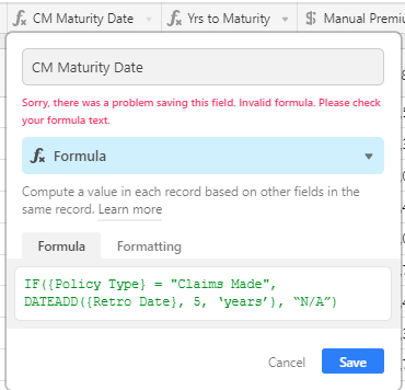

Put “Claims Made” in double quotation marks, and use the word ‘years’ (in single quotation marks).
  • April 27, 2021
Welcome to the community, @Lori_Hein!
Thanks, Scott!
It gave me an error:
Thanks, Scott!
Airtable only accepts straight quotes instead of stylized quotes, so adjust the single quotation marks that you have around the word ‘years’ so that it looks like this: 'years'. Same thing with the word “N/A”… it needs to look like this: "N/A".
  • April 27, 2021
I fixed the quotes, which took care of the error, but I’m still only getting the N/A in every row, even for Claims Made policy types. It’s like it sees all the policy type entries as Occurrence.
You may want to check to make sure that the values that you typed into the “Policy Type” field don’t have any extra spaces in them (before, after, or in between the words). Airtable doesn’t actually visually show you extra spaces onscreen… you have to manually double-click into the fields to see the spaces.
  • April 27, 2021
That was it; thanks so much!
