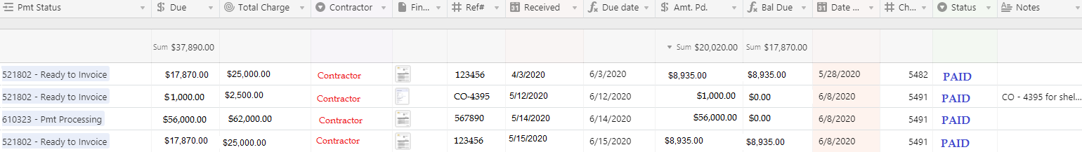

@Aron Here is a better visual of my base, focusing on my question.
As I said, I’m not sure what option would be best to configure a field to get the results needed.
Amount Due is the amount due to the contractor.
Amt. Pd. is the amount paid out (reflecting the date/check #)
Bal Due is the formula currently using to show the remaining balance due.
As invoices come in from the contractor the amount due from contractors’ invoice is submitted. The record highlighted inside the “blue box” is a partial payment made.
The amount due highlighted in the “red circle” in the next record is inputted as the full amount due (invoices come in on different dates and inputted by those who do not have access to see/know if a previous payment is made. This affects the Sum, Balance Due, and Amt. Pd.
It seems obvious to have the Amt. Due easily inputted as the Balance Due, but with over 100 invoices coming in weekly, and several people inputting data, on top of the filtered views after payment is made there is no way to tell if and how much of a balance remains.
I hope this explains it better.
