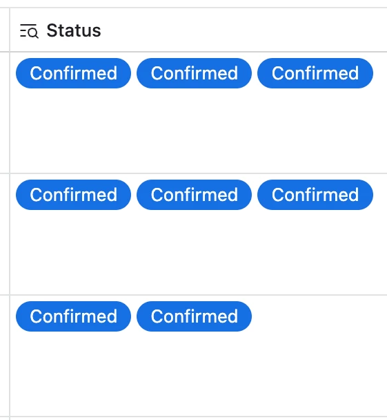

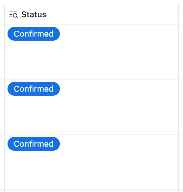

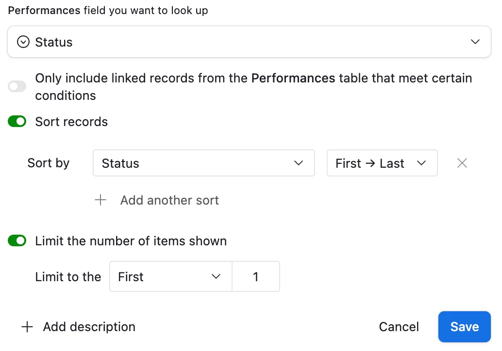

In my case, I had a single-select column being referenced in another rollup column. The result of the rollup was being used to determine a third formula column, using the option to output the value of the formula as a single-select value.
A couple weeks ago, this setup worked as expected. Then, without any change on my part, the third formula column started returning only the fallback value, regardless of the input received.
I took the advice here and changed my approach to use a lookup column instead of that third formula outputting a single-select value. In my case, I was able to do the same algorithm, but now there are fewer intermediary steps. With this change, only a single column was needed to do the work of the previous two.
The insight came in understanding that a Lookup can return multiple single-select values when referencing a set of multiple linked records. From there, I was able to use the filtering and sorting options to get the output I needed by operating directly on this list of single-select values. Feels a bit odd in implementation, a lookup returning multiple values, but once you understand this is possible, the rest comes naturally.
While this workaround was successful in my case, the fact remains that some internal change caused a regression in the expected behavior of the fomula-to-single-select functionality. Hope the teams gets that one sorted out soon.
See this sequence of screenshots for context on the Lookup single-select approach:
Lookup field, each row returns the single-select value from a list of linked
Sorting and limiting the number of returned records helped me recreate the desired functionality.
Resulting lookup table returns a single-select value as if it were a single-select field itself.

The only challenge you’ll encounter is when multiple distinct values exist. Restricting the limit to 1 will prevent the display of any additional values that may be present
