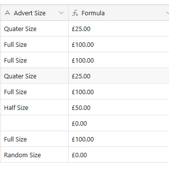

I am hoping that someone might be able to help with a nested IF Statement I have a field that determines the size of an advert. I want another field to list the price for the advert based on the selection in the first column.
This is the If Statement I created, but something is not quite right because it always shows the value £0.00
  {Advert Size}='Full Size','£100.00','£0.00',
  IF({Advert ID}='Half Size','£50.00',
  IF({Advert Size}='Quater Size','£25.00','£0.00'
Thanks in advance for your help.

Best answer by Alexey_Gusev
In your example, error is '£0.00',  in first line.
In common, it should be IF ( condition ,  _when condition is true_  , _when condition is false_ ) , but then you should substitute last argument and start next line right after  _when condition is true_  ,
Anyway, your case has better and easier readable solution - use SWITCH
SWITCH({Advert Size}, 'Full Size','£100.00', 'Half Size','£50.00', 'Quater Size','£25.00', '£0.00')

Hi Alexey_Gusev,
Ooooo I like this. Thanks. I had tried without the £0.00 on the first line but it still didn't work. Now I guess that's likley because the order of the formula is back to front.
However, your {SWITCH} Solution is far more elegant. Thanks for the help.
