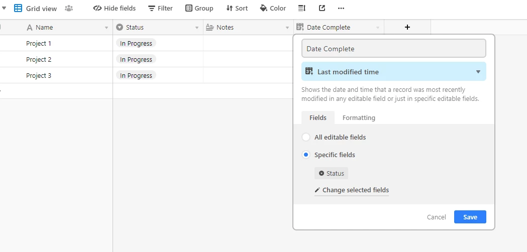

Hello Lucas,
There’s a field in Airtable called Last Modified Time as shown below:
You are able to specify when this field shows an updated date/time by choosing the specific fields button and it will look something like this:
This way, when your status is changed, the last modified time will also change, like so:
If you don’t want to use a single select to mark complete, maybe you could use a checkbox field and as soon as that is filled out, the field gets updated in the same way.
Hopefully I was able to capture what you needed. Good luck!

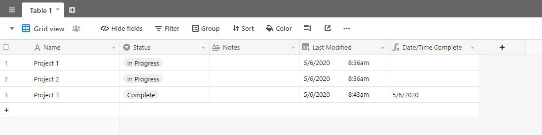

Ah, I understand, my bad. Maybe this will work.
Keeping the same table as above, you could create a formula field that shows the date/time from the last modified field but only if the status of that project is complete.
The formula and a picture of the table where the formula is placed in the “Date/Time Complete” field:
if( Status = "Complete" , DATETIME_FORMAT({Date Complete} , 'M/D/YYYY'),"")
Here’s a helpful link that lists what you can use in the DATETIME_FORMAT Function (where I used ‘M/D/YYYY’) :
Hopefully I was able to get what you needed this time. Let me know if you had any other quesitons/issues.

Thanks a lot, Sam! It helped and it works perfectly.
