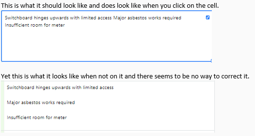

This is driving me nuts. I have a long text field (rich text turned off) that seems to have multiple line breaks.
Formula I used was Substitute(Field,“\n”,“”) and while it seems to work it also doesn’t. I tried with putting in a value instead of “” so I could see it working and it is working but also airtable seems to be keeping paragraphs anyway.
Any help would be greatly appreciated.
Best answer by Brent_H
Ok I seem to have stumbled onto the solution substitute does not work for \r removal which I had tried already only regex_replace works but only on the original text column not if it is a lookup column.
REGEX_REPLACE(REGEX_REPLACE(Field,“\n”,“”),“\r”,“”)

Hi Brent - loved this solutions unfortunately I am still getting stuck on 2 stubborn line breaks
I need help - my CSV file is downloading the line breaks in my long text fields - I tried to eliminate them by running >REGEX_REPLACE for \r, \n, \r\n, u2028, u2029, u0085, u00B6
This took care of most of the line breaks but there are still 2 stubborn line breaks I cannot beat HELP!
