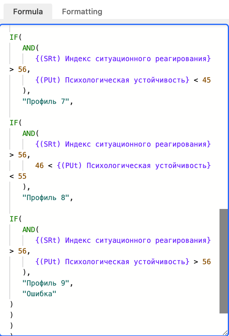

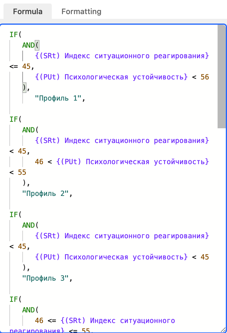

Logical operators within the "IF" function

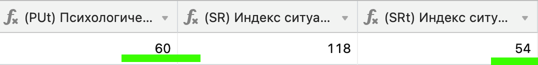

I have two values “PUt” and “SRt”
With different values of these fields I need to output different “Profiles”.
When I write a formula to compare these numbers, I get the wrong answer from the formula.
Values:

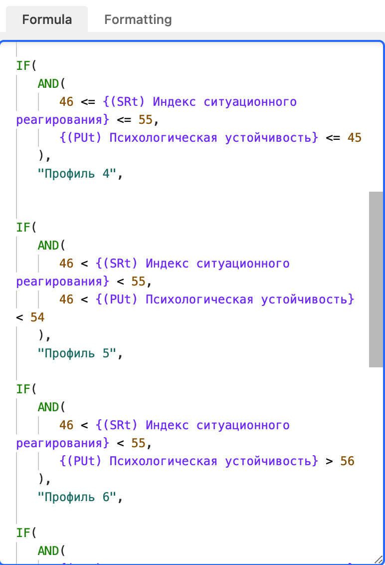

This is my formula:
Logically, the formula should select “Profile 6”
But the cell shows “Profile 5”.
Hm, I don’t think that you can do [NUMBER] < [VALUE] < [NUMBER], actually
I think you’ll need to separate them each out into single lines, e.g.
  AND(
    46 < SRt,
    SRt < 55,
    46 < PUt,
    PUt > 54
  'Profile 5',
    AND(
      46 < SRt,
      SRt < 55,
      PUt > 56
    'Profile 6'

Didn’t even think of that decision :grinning_face_with_sweat:
Thanks so much, buddy!
