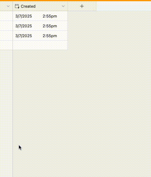

Try converting your existing ‘Created’ type field into a Date field and toggle on ‘Default to Current date’?  That way your formulas, dashboards etc won’t be affected since the data’s the same while also allowing your team members to key past data in moving forward
