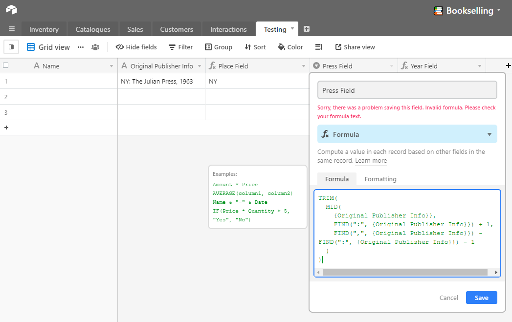

I tried this solution, but my publisher info does not contain any line breaks so, of course, it didn’t work. I tried replacing the formula’s “\n” with “:” since place and press are separated by a colon, but that only eliminated the colon and kept the rest of the publishing info together. :confused:

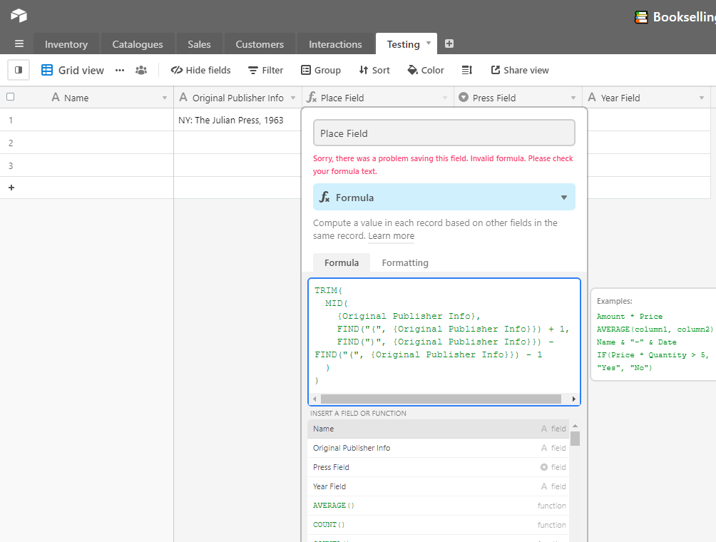

Maybe I’m misunderstanding, but this formula yielded a blank cell for me. I tried it three different ways:
1
TRIM(MID({Original Publisher Info}, FIND(":", Name) + 1, FIND(",", Name) - FIND(",", Name) - 1 ))
2
TRIM(MID({Original Publisher Info}, FIND(":", Place) + 1, FIND(",", Press) - FIND(",", Year) - 1 ))
3
TRIM(MID({Original Publisher Info}, FIND(":", Place + 1))
The third way, I would have repeated separately for each pull-out field, but I got an error message saying, “Can’t save field because it causes a circular reference.”

A: If your field is named {Original Publisher Info} you have to replace the name of the field everywhere, not just at the start of the formula. The formula I gave only ever references one field.
B: Your separators are, in order: the opening parenthesis, the colon, the comma, the closing parenthesis. If your publish location is NY, then the START of that isn’t the colon.
C: The pattern for the FIND formulas as I wrote them are START, END, START. you did START, END, END.
D: If you got the circular reference error that means you tried to reference the field {Place} inside of the formula for the field {Place}, which as you’ve learned you cannot do. Aside from that not being the pattern I suggested, there shouldn’t be a colon in your {Place} field anyway.

The formulas for Place and Year worked! :slightly_smiling_face: But Press didn’t work, maybe because I’m not clear on which formula I’m supposed to use there

For every field name reference you included an extra } at the end.
Forum|alt.badge.img+14
  • October 23, 2020
Yikes! Egg on my face. You’re right. It worked. Thank you both so much for your help. :heart:
