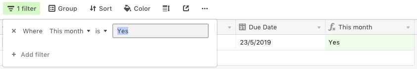

I want my applicant tracking system to automatically load the rows FOR THE CURRENT MONTH. I want all other entries hidden somehow.
Users send in entries via a form, the data is sent to a base, and then staff members operate on the data. But there should be some way to set DEFAULT views so that the entire 1000+ rows are not loaded each time.
How do I do this?
Best answer by Julian_Kirkness
Hi @Richard
Thinking about this, you are going to need to create a formula which works out whether each record is in the current month (because there is no filter option to do this as standard) and then filter on that formula field - this should work:
Then simply create a view with a filter if {This Month} is Yes…
Hope this helps!

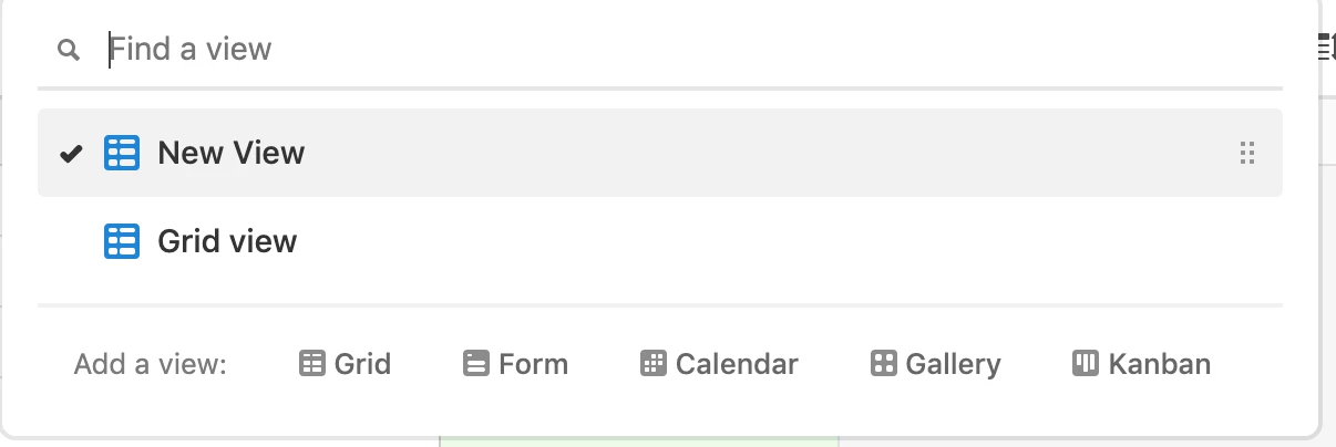

Hi @Richard - you need a view on your table which filters out items more than a month old. You can have multiple views on the same table:
More info here:
There’s a section within this about filtering too
JB
Hi @Richard
Hope this helps!
Julian

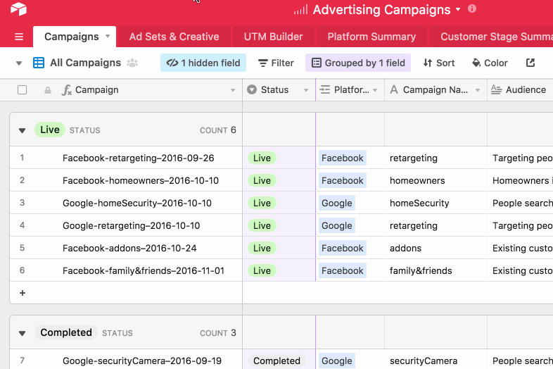

Here’s a statement about choosing the default view from an Airtable employee:
In my experience with Airtable the default view for each table doesn’t matter much because the web client remembers the view I last used and doesn’t send me back to the default when I switch tables.
