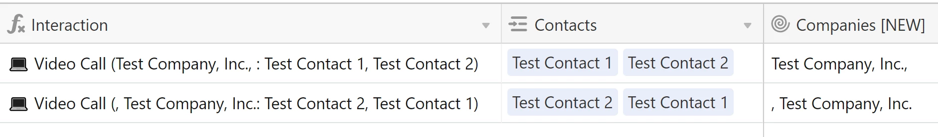

There’s a hiccup in instances where there isn’t a Company match to a Contact - an arbitrary coma is inserted. In the example below, Test Contact 2 is not associated with a company.
I’m sure this is an IF statement - I’m not terrific with these but working on it.

Thanks for your input! I hadn’t, but just did.
Then you need to have ARRAYCOMPACT in there as well. ArrayJoin has to be on the outside, it should not matter whether you put Compact outside or inside Unique.
