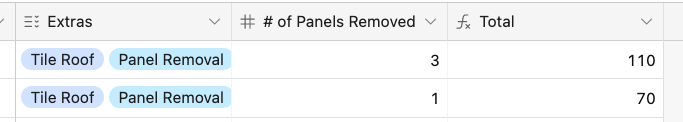

Hmm, maybe use a new field called "# of Panels Removed" or something, and have the formula use that?
IF( FIND('Tile Roof', Extras), 50 ) + IF( FIND('Panel Removal', Extras), {# of Panels Removed} * 20 )
  • July 13, 2024
Yeah I think this is a good solution, thank you!
