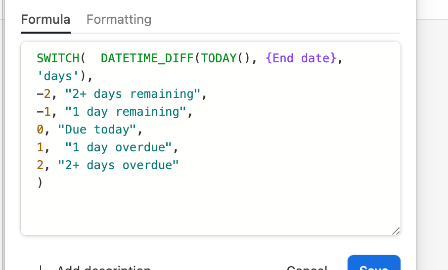

OK, not an expert here, but I have written a few nested IF and SWITCH statements so in the absence of any other answers, try this:
To me, your use of brackets and '&' look more like an attempt to concatenate (join) separate answers rather than nest them. Try nesting your IF statements within the brackets rather than using '&' to produce another argument or expression. So without writing 'IF' again after the first argument, make another argument after the second comma.
An even better option could be not to use IF at all, but to utilise the more recently added "Switch" command. If you are not familiar with it, worth looking up. It breaks down such complicated nesting into a much easier to read and understand sequence and is supported by Airtable.

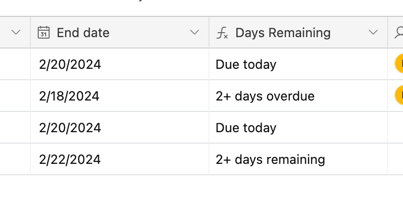

Dan_Montoya
SWITCH( DATETIME_DIFF(TODAY(), {End date}, 'days'), -2, "2+ days remaining", -1, "1 day remaining", 0, "Due today", 1, "1 day overdue", 2, "2+ days overdue" )
Forum|alt.badge.img+9
Thanks for that Dan, just what I was trying to suggest! Hopefully now Tt will simply be able to copy and paste.

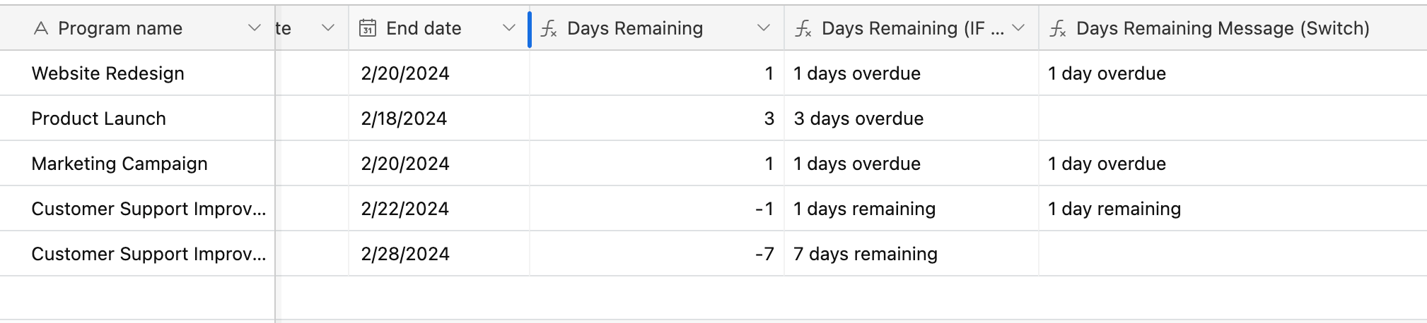

Tt25_2
  • February 21, 2024
Although it seems switch only works for discreet numbers, is there any way of specifying a range? I tried using <2 but I'm not sure if I'm getting the syntax correct
Dan_Montoya
If what you want is the actual number of days, then I would it with two fields
IF({Days Remaining}< 0, CONCATENATE(ABS({Days Remaining}), " days remaining"), IF({Days Remaining}> 0,CONCATENATE({Days Remaining}, " days overdue"), "Due Today" ))

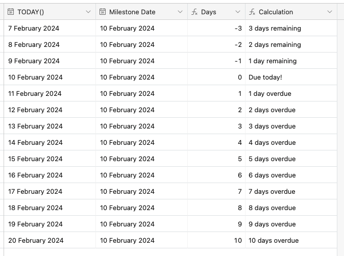

Another way to deal with this would be to not nest your IFs at all, which I sometimes favour because it's just easier to read:
IF( Days = 0, 'Due today!' ) & IF( Days = -1, ABS(Days) & " day remaining" ) & IF( Days < -1, ABS(Days) & " days remaining" ) & IF( Days = 1, ABS(Days) & " day overdue" ) & IF( Days > 1, ABS(Days) & " days overdue" )
