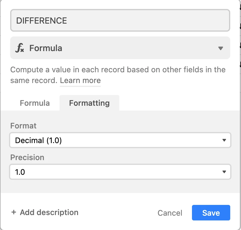

1) Can you confirm that the formula field is configured to show decimals like the below photo?
2) Here is the same formula, but I've added and IF() statement. If the outcome of the original formula is an error, then the entire formula will return BLANK(), otherwise it will return the non-error output of the formula.
ISERROR((DATETIME_FORMAT(DATETIME_PARSE(OUT, 'h:mmA'), 'X')-DATETIME_FORMAT(DATETIME_PARSE(IN, 'h:mmA'), 'X'))/60/60),
BLANK(),
BLANK(),
Thanks again, everything works, decimals and IF. No more questions
