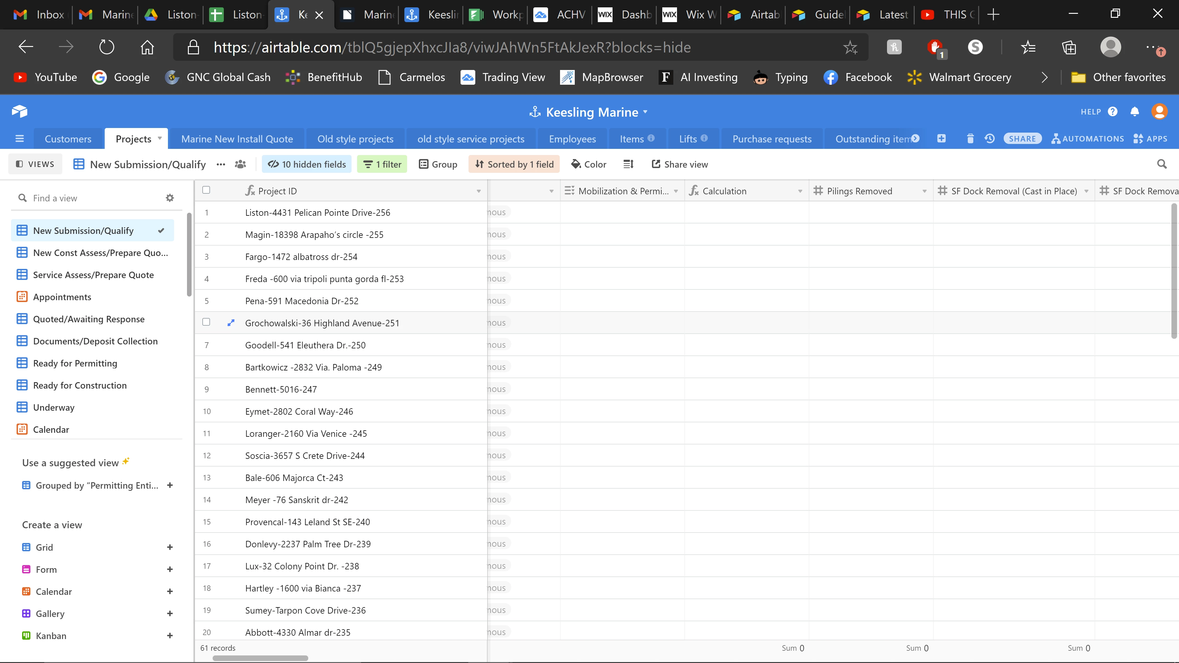

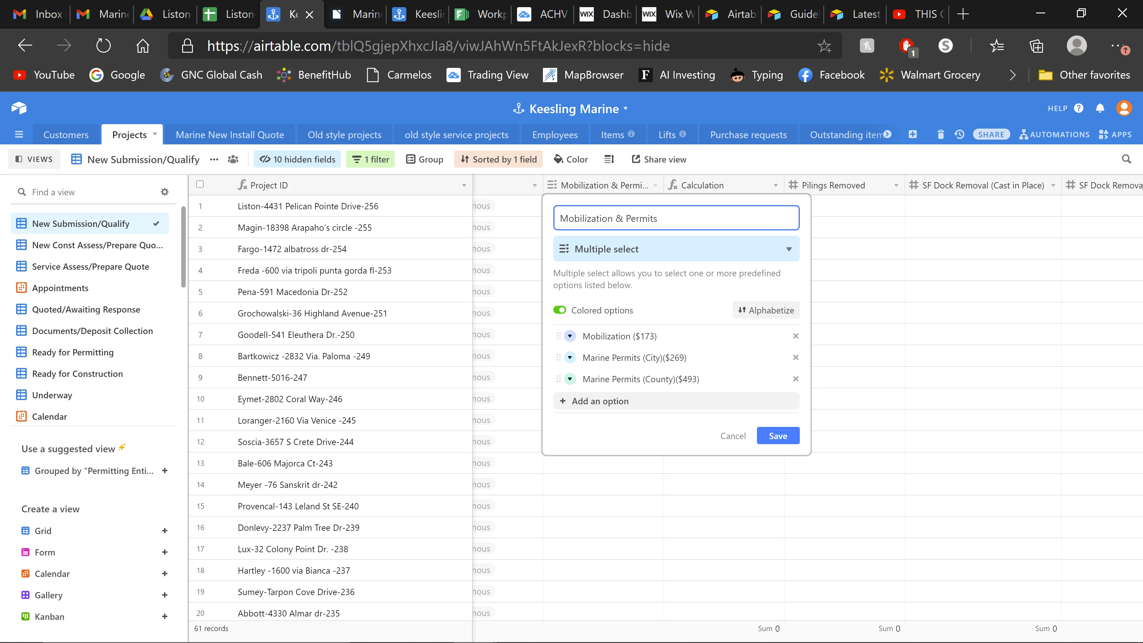

I am trying to come up with a formula that when I select an item from my multiple select field it uses its separate value to add to the total quote total.
Any advice would be greatly appreciated.
6 replies

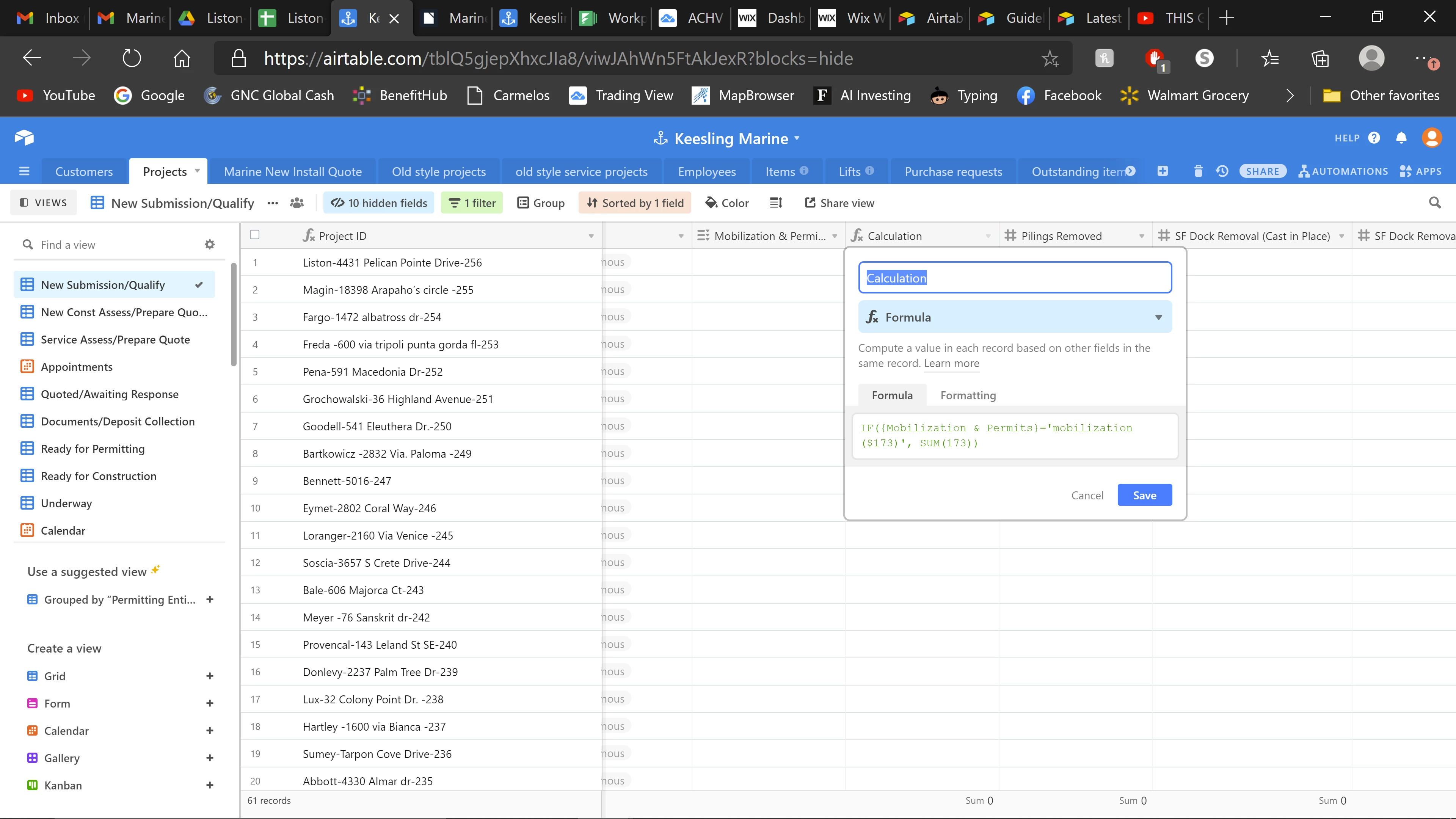

Welcome to the community, @Jack_Albers! :grinning_face_with_big_eyes: This wasn’t explicitly stated in your comment, but I’m guessing you want to possibly select multiple items in that multiple select field, and have all of their related values added together to contribute to the final result. Is that correct? If so, I suggest considering a slight redesign of your base.
Extracting a single value from a single selected item is pretty easy. Extracting multiple values from multiple items is not currently possible, at least using formulas. Airtable’s formula system doesn’t provide functions for iterating through an arbitrarily-sized collection of items, which would be necessary to extract those separate values.
A much easier way would be to build a new [Mobilization & Permits] table for those items. In fact, you could convert your existing multiple select field into a link field to a new table, and Airtable will automatically make entries in that table matching your existing multiple select entries. In that [Mobilization & Permits] table, add a number field that contains the value for that item. Back in your [Projects] table, add a rollup field that sums all of the values of the linked items.

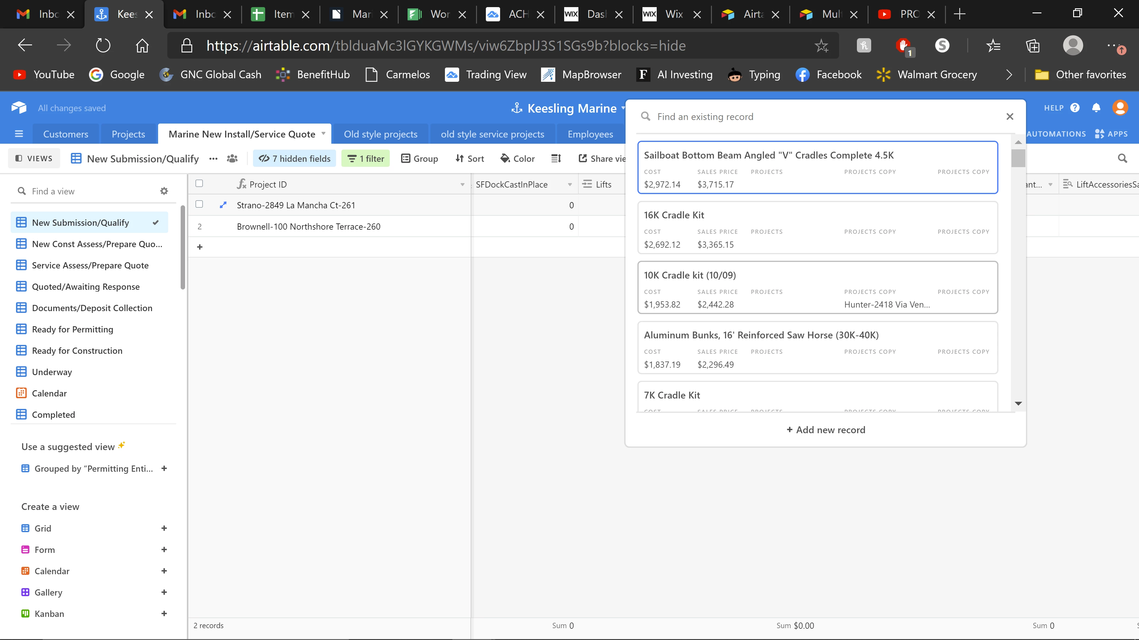

Sorry for any confusion. My main question is how can I link an item multiple times that adds the price value and just stays with that project. I am trying to be able to make quotes for customers but for example if they need 12 piling caps and I select the piling caps it only does one at its base price. Now I have attempted to place a quantity field and link that field with the item and tie it to my quote total but the only problem with that is if I have another quote with the same items, it adds the quantities from the previous projects.
In plain jane I would just like to add items multiple times to specific projects while maintaining its unique quote total and not messing up other projects.

Thanks for the clarification, and sorry for the delay. This situation is a great use case for creating a junction table. Create a table named something like [Line Items]. In that table you’ll have at least the following fields (aside from the primary field; we’ll get to that in a bit):
  • Project - This is a link to your [Projects] table; one link per record.
  • Item - This is a link to your [Items] table; one link per record.
  • Quantity - This is a number field where you specify the quantity of the selected item that you need for the selected project.
  • Total Price - This is a rollup field, bringing in the price of the linked item and multiplying it by the value in the {Quantity} field. The aggregation formula would be: SUM(values) * Quantity
Each record defines a relationship between a project and a specific quantity of an item. This way the same item can be used in varying quantities for multiple projects without mixing data between projects.
For the primary field, change it to a formula. This is just one possible option, but the idea is to make it unique enough that you know all of the core details at a glance:
IF(AND(Project, Item, Quantity), Quantity & " x " & Item & " (" & Project & ")")
Back in your [Projects] table, add a rollup field that adds all of the values from the linked [Line Items] records, using the SUM(values) aggregation formula. That will give you a sum of all line items.
