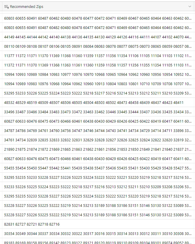

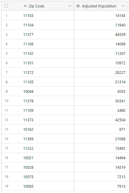

I have two data tables;
  • Table 1 has records with "recommended zip codes" these zip codes are in a single delimited field
  • Table 2 has a data table with zip codes and corresponding populations
Ultimately I just want to find the total population for all zip codes listed in the single field (even within an interface)
I can see this being solved in two different ways:
  1. a formula to recognize each separate value stored in the same field
  2. some way to separate all the separate zip code values into distinct columns within the same record
Any ideas on how to solve for either of these?
