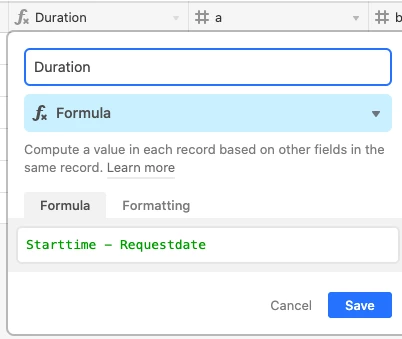

NaN after calculating Duration
  • September 17, 2020
  • 30 views
The formula is indicated on the screenshot. How to get Duration value, not a NaN?
Best answer by kuovonne
Math with dates can get a little tricky. Sometimes you need to use a function instead of a simple operator.
DATETIME_DIFF({Starttime}, {Requestdate}, 'seconds')
It is documented in the formula field reference.
