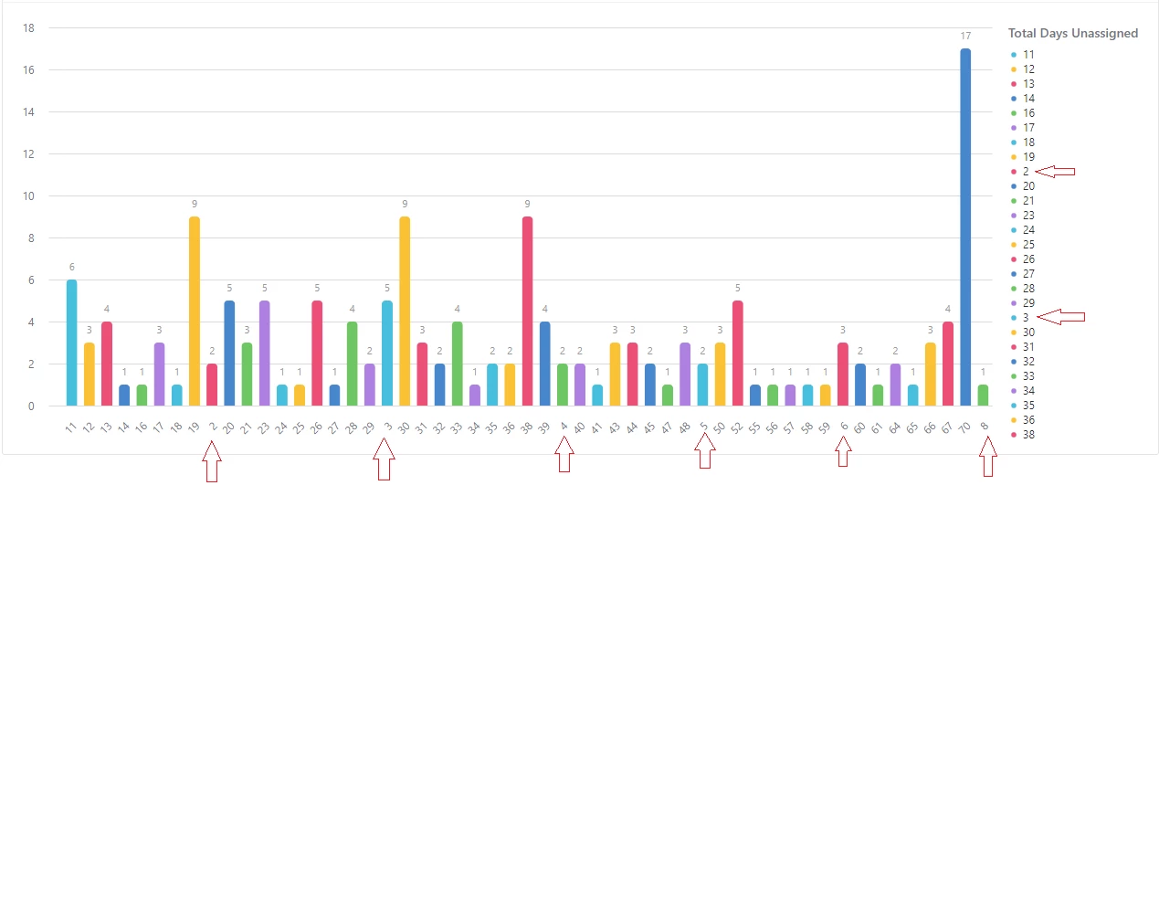

Need a field that reflects a number beginning with 01 based off a formula in another field
I have a field with a formula that calculates total days using this formula:
IF({Status 📝}="Unassigned", WORKDAY_DIFF({Create Date},TODAY(),'2023-09-04'), "N/A")
The formula works, but returns results of 1, 2, 3 etc., which when i try to use this column in a graph it does not sort correctly.  I need the results to be 01, 02, 03 to be able to sort in ascending or descending order or I need a field that reads the formula field and converts it to a number that can be sorted.
Any suggestions are appreciated.
Best answer by Sho
It appears that the field is being sorted as a string type because of the "N/A" in the return value of false. If the return value is removed, the field should be sorted as numeric.
IF({Status :pencil:}="Unassigned", WORKDAY_DIFF({Create Date},TODAY(),'2023-09-04'))
  • October 4, 2023
That was it - thank you very much.
