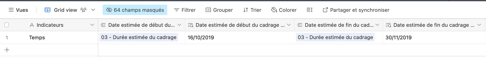

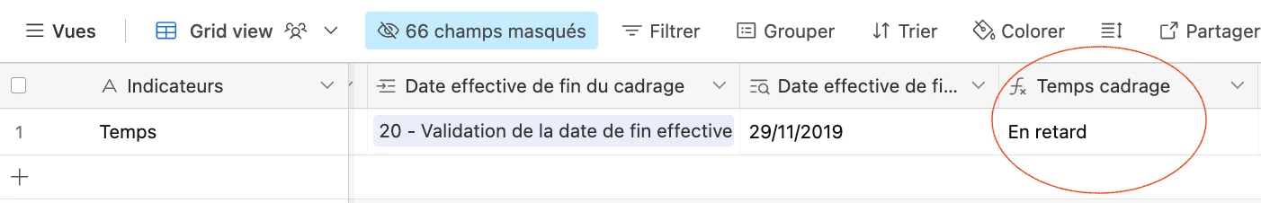

I want to create an IF formula but the result I get is not what I expected
Here is the formula: IF({Date effective de fin du cadrage (from Date effective de fin du cadrage)}<{Date estimée de fin du cadrage (from Date estimée de fin du cadrage)},"In time","Late")
I want to get: "In time" if the effective end date of the scoping is before the estimated end date of the scoping and I want to get "Late" if the effective end date of the scoping is after the estimated end date of the scoping
However, I'm getting "Late" whereas I should get 'In time".
Could you please help me? Thank you very much

Hi @JustineC,
Date and time comparisons require the use of a dedicated function.
IS_SAME(), IS_BEFORE(), IS_AFTER() and DATETIME_DIFF(). Read the reference for details.
Formula Field Reference - Overview | Airtable Support
For example, like this
IF( IS_AFTER( {Date effective de fin du cadrage (from Date effective de fin du cadrage)}, {Date estimée de fin du cadrage (from Date estimée de fin du cadrage)} ), "In time", "Late" )
