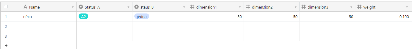

Thanks for this - its nice, understandable, BUT…
BUT if i copy, it works - thats fine. If i add other conditions in this way…it works.
The truth is, i still dont understand those logic of this IF (but thats problem in mine head - time will make it bettter-i hope).
so…the full situation:
the conditions:
there are more options in status_A and status_B, but i need this formula only for those:
if status_A = “A2” and status_B =“jedna”, than it should be “K”
if status_A= “A2” and status_B =“dva”, than it should be “L”
if status_A= “A2” and status_B=“tri” and weight * 1000 <=10, than it should be “O1”
if status_A= “A2” and status_B=“tri” and weight * 1000 >10, than it should be “O2”
if status_A= “A2” and status_B =“ctyri”, than it should be “O”
for all other statuses A and B
if all dimensionX<=50 and weight * 1000 <=250 it should be “M1”
if all dimensionX<=50 and weight * 1000 >250 and <=500 it should be “M2”
if all dimensionX<=50 and weight * 1000 >500 it should be “M”
if all dimensionX>50 and weight * 1000 <=250 it should be “N1”
if all dimensionX>50 and weight * 1000 >250 and <=500 it should be “N2”
if all dimensionX>50 and weight * 1000 >500 it should be “N”
now i dont know how to make formula - waiting for your help.
Thanks again

i end with error, well its not an error, but something is wrong :frowning:
ok, the M selection is right, but when i want to make the N section -
i make it as
OR(
{rozmer1} > 50,
{rozmer2} > 50,
{rozmer3} > 50,
{vaha} * 1000 <= 250
"N1",
OR(
    {rozmer1} > 50,
    {rozmer2} > 50,
    {rozmer3} > 50,
    {vaha} * 1000 > 250,
    {vaha} * 1000 <= 500
"N2"
what i want to say (to do airtable) is
if any of the rozmerX >50 and the vaha * 1000 <= 250, than make it N1
thats functional in this case.
But if i give the vaha 0.251 it wont give me N2 (the condition should be
if any of the rozmerX >50 and the vaha * 1000 > 250 and <=500, than make it N2
feel stupid, but i cannot go over this :frowning:
can you look at it, please, and tell me, what am i doing bad ?
Thanks
