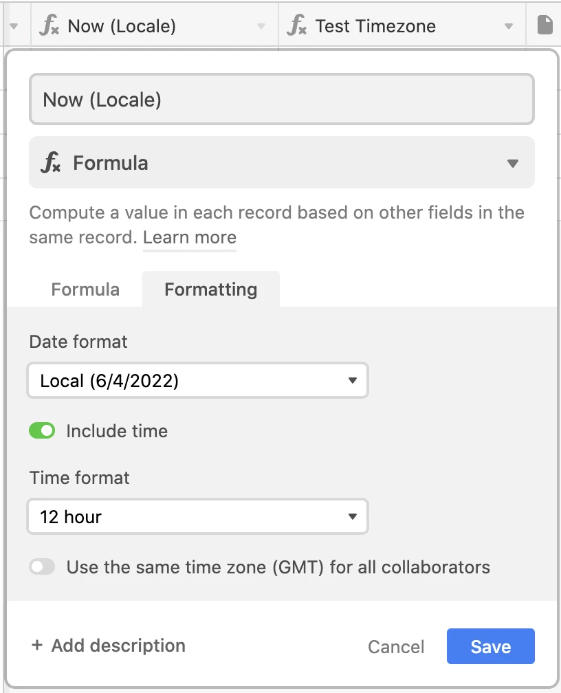

Why not just parse the date off of Now() set to local time?
The local time toggle in the user interface only affects the display of the time in the user interface. It doesn’t change the fact that the underlying value used in formula fields is GMT/UTC.
In Airtable, the concept of local time only exists in a specific client. Formulas are not client specific, and thus date/time values are always GMT unless you use SET_TIMEZONE or do some other workarounds like manually adding an offset.

@Doug_Gregan It sounds like my sample base would be of most help to you, since it specifically handles these time offsets.
