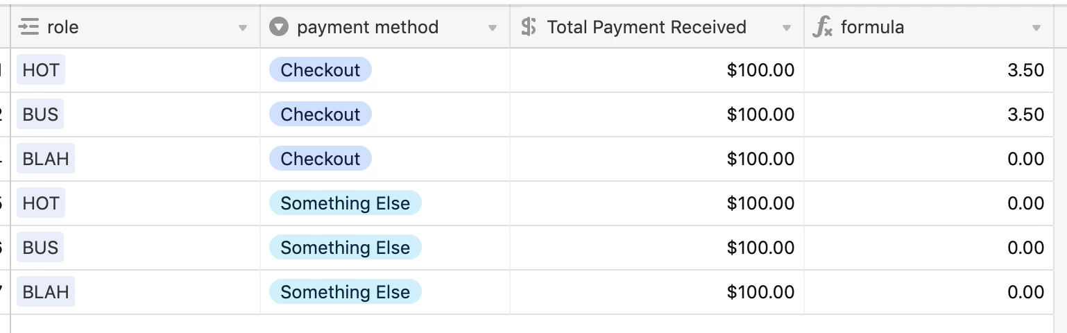

Hey,I am looking for some help with a formula I am working on.
I’m trying to achieve the below statement.
IF {role} = “HOT” OR “BUS” AND {payment method}= “Checkout”, then ({Total Payment Received}*0.0275+0.75) ELSE 0
THE {role} within my formula is a “linked” field so I am unsure if that is causing an issue?
Any help would be really appreciated.
Thanks

HI @Harrison_Jones - this is what you need:
  AND(
    OR({role} = 'BUS', {role} = 'HOT'),
    {payment method}= 'Checkout'
  ({Total Payment Received} * 0.0275) + 0.75,
  0
Format the formula column to be integer or decimal as you require.

JB you are a HERO!!!
Thank you so much.
