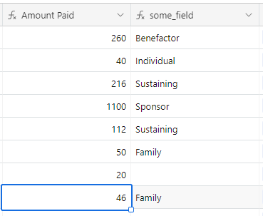

The formula is not quite correct. Expression AND({Amount Paid}=25, {Amount Paid}<45) is a mistake because it's equal to IF({Amount Paid}=25. For 24 or 26, same as for 35, it's false, AND means both statements must be true, and here "nothing is equal to 25, except 25".
You should start with AND({Amount Paid}>25, {Amount Paid}<45), ' "Individual",
then IF(AND({Amount Paid}>45, {Amount Paid}<60), ”Family”, and so on..
in the end,  IF(AND({Amount Paid}>250, {Amount Paid}<1000), must be 'Benefactor, and the last must be IF({Amount Paid}>1000,"Sponsor", "")
Second flaw is that you defined option for <45  and for >45 , but not for =45. So, you should write each first expression in line as "more or equal", for example  AND({Amount Paid}>=25, {Amount Paid}<45), ' "Individual"
and so on...
I would write it as:
SWITCH(
({Amount Paid}>=25) + ({Amount Paid}>=45) + ({Amount Paid}>=60) +
({Amount Paid}>=100)+({Amount Paid}>=250)+({Amount Paid}>=1000),
0,'',
1,'Individual',
2,'Family',
3,'Patron',
4,'Sustaining',
5,'Benefactor',
6,'Sponsor')
