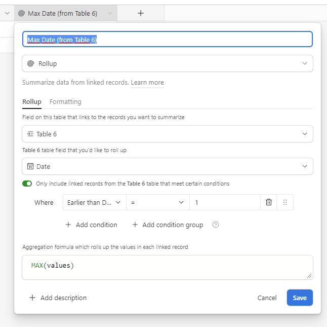

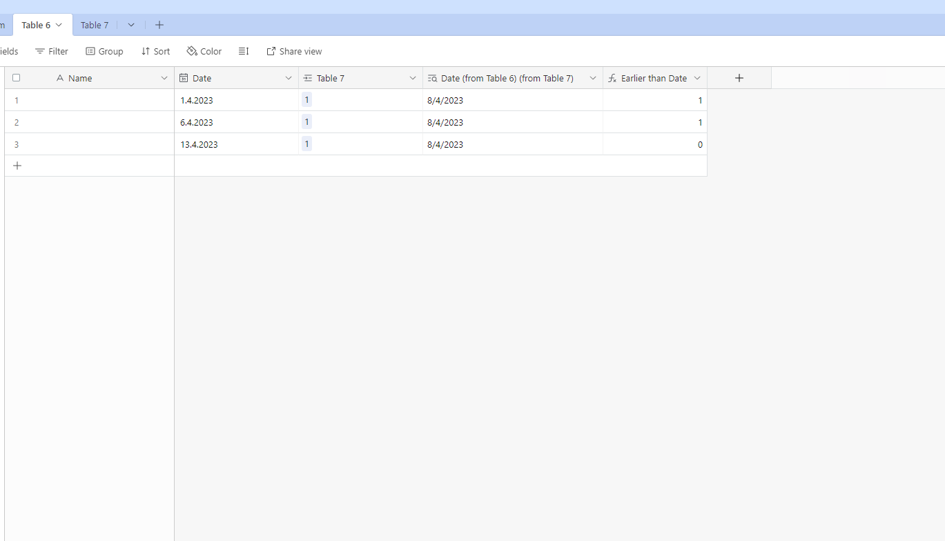

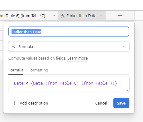

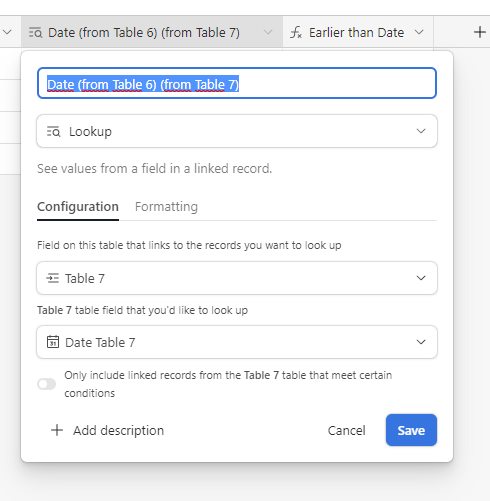

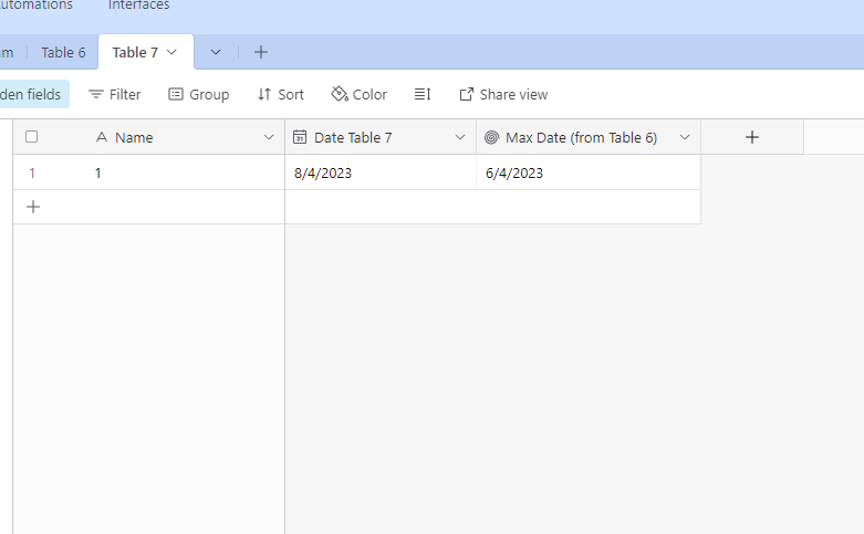

Best answer by Abdullah_Yuksel
I hope the screenshots I shared are explanatory 😊
Forum|alt.badge.img+10

I was able to revise my base design and use the solution provided, thanks!
