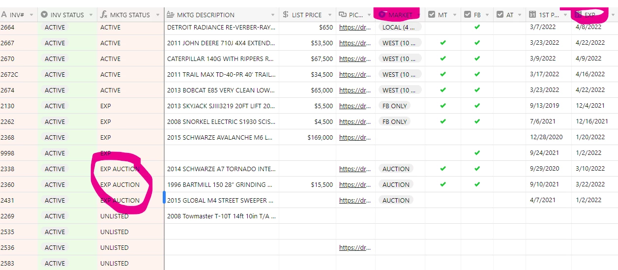

Here’s a screenshot to show what I’m working with:
Thanks for the clarification. In that case, the “Auction” test should come first, and the rest after that.
I also optimized the test for an empty {EXP} field. Comparing a date field against an empty string will technically work, but NOT({Field Name}) is a streamlined way to look for almost any empty field. You can also omit the curly braces around the field names because they’re only single words with no special characters.
See if this does what you want:
    MARKET = "AUCTION", "AUCTION",
        NOT(EXP), "UNLISTED",
            EXP < TODAY(), "EXP", "ACTIVE"
