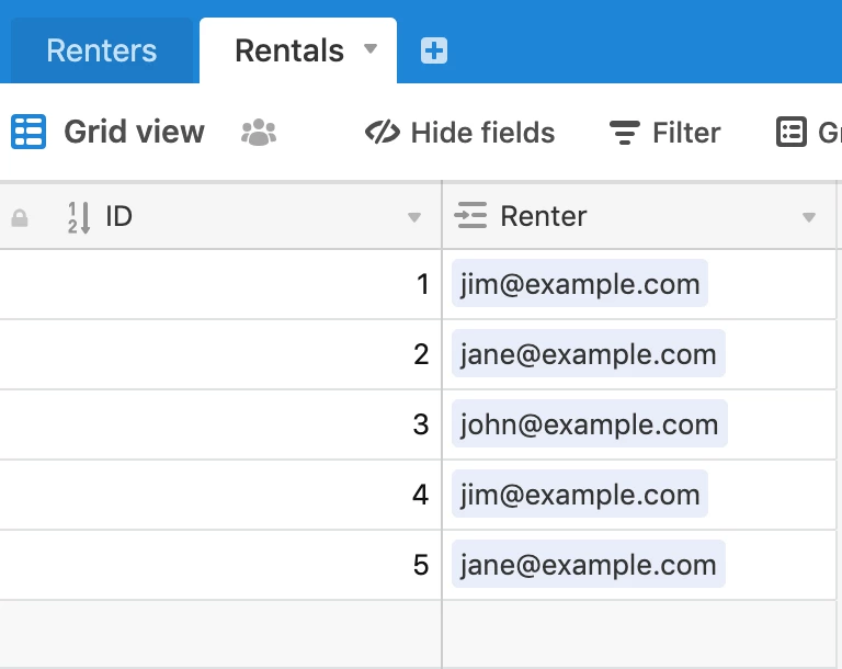

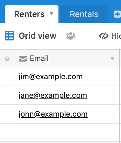

Hi @Harrison_Jones - from your description it sounds like you have the renter email on each record in the table and in GSheets your formula is able to iterate through all of the records and find a match or not. Airtable can’t do that kind of iteration over records in the same way, so the best way to achieve is this to separate your renters and your rentals into two tables - something like this:
Renters:
Rentals:
So the “renter” field on the rentals record is a link to the renters table.

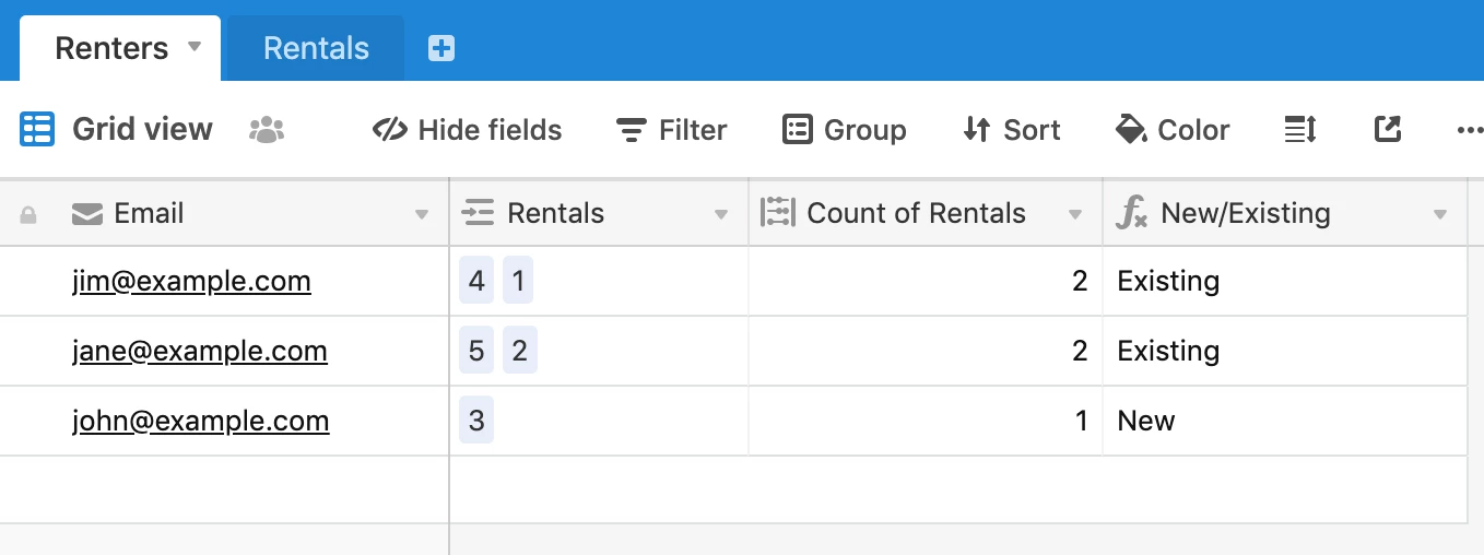

Now, back on the Renters table you can count the number of rentals and then have a formula where if the count is greater than 1 they are existing, otherwise new:
IF({Count of Rentals} > 1, 'Existing', 'New')

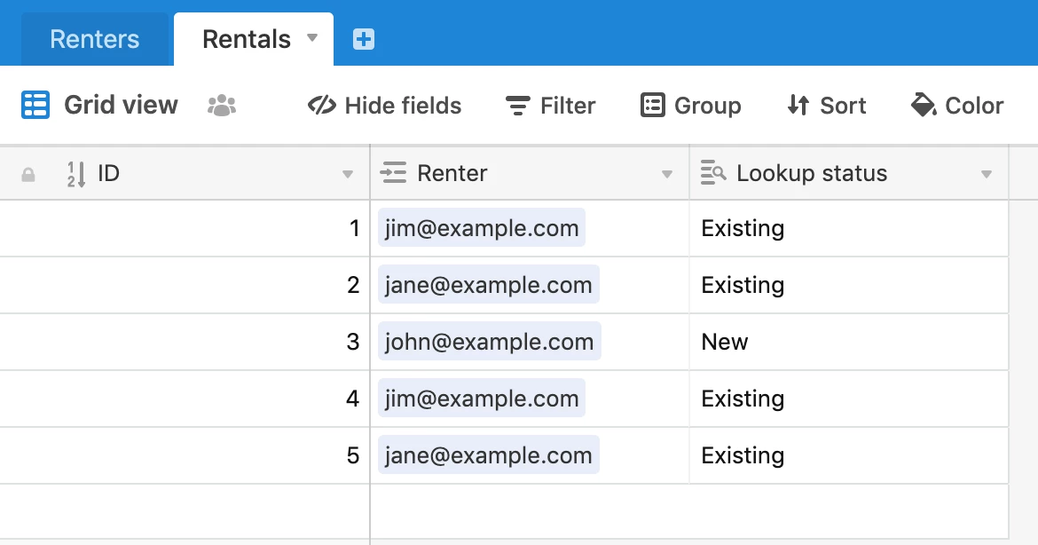

This new/existing value can be pulled back to the rentals table too if you want using a lookup:
