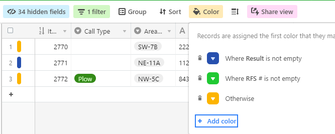

If you have a pro version you can color code the rows. Unfortunately, you cannot color code the actual result. (The green word PLOW you see in my image is a Single Select field where I used colors.)
You are a Pro!!! :star_struck: I was a Free user for some time and now that I’ve upgraded to Pro I feel like I have a lot to learn!! Many Thanks!!!
