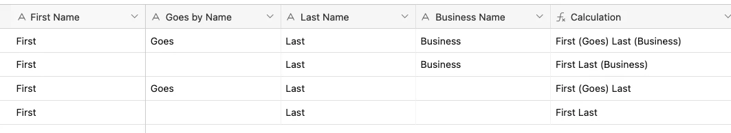

Hm, I think I'd set up my formula to be like so instead:
{First Name} & " " & IF( {Goes by Name}, "(" & {Goes by Name} & ") " ) & {Last Name} & IF( {Business Name}, " (" & {Business Name} & ")" )
Resulting in:
Resulting in:

This worked, thank you so much!
