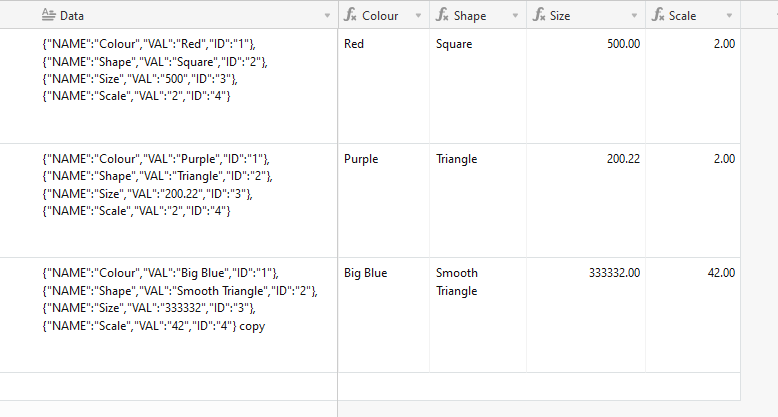

Woo hoo, I finally found my solution! I needed to employ Regex Grouping using (), and Airtable returns the first group.
REGEX_EXTRACT(Data,'Size","VAL":"(.*)",')
So again, using this input;
{"NAME":"Colour","VAL":"Red","ID":"1"},
{"NAME":"Shape","VAL":"Square","ID":"2"},
{"NAME":"Size","VAL":"500","ID":"3"},
{"NAME":"Scale","VAL":"2","ID":"4"}
We can now easily extract values of variables into their own field using the same formula, but simply swapping out the variable name, Colour, Shape, Size etc.
Remember to wrap Integers or Decimals with ABS() too if not wanting a text string for numbers.
This is tidy as, I love it! Thanks @kuovonne and @ScottWorld - hopefully this might help you both too.
EDIT: Lol, the plot thickens. My test data had new lines, but unfortunately my real world data is one very long string, and now I have to figure out why Regex selects the very last ", in the string, rather than the next ", :sob:
Ahh ha! Added a ? to the wild card, which makes the search “non-greedy”.
REGEX_EXTRACT(Data,'Size","VAL":"(.*?)",')

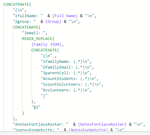

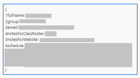

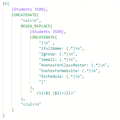

I’ve used formula fields to parse JSON-like text. I rely heavily on regular expressions for the task. That is also why I use JSON-like text, but not actual JSON. I only use it with JSON-like text that I create and fully control.
Here is part of a formula that I use to create my JSON-like text.
Here is the result of that formula:
Here is one formula where I parse out a rollup of that JSON-like text.
Thanks so much @kuovonne - JSON-like parsing should work, and thank you kindly for sharing your example. I will see if I can adjust it to suit.

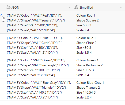

Something I’m trying now - First step is the simplification of the data;
REGEX_REPLACE(
REGEX_REPLACE({JSON},
'["NAME","VAL","ID"]',''),
This returns;
Colour Red 1
Shape Square 2
Size 500 3
Scale 2 4
So, next I need to figure out on how to search the word “Colour” and then return the following full word. And search the word “Size” and return the following number (including possibility of decimal).
REGEX_REPLACE(
This returns;
Colour Red 1
Shape Square 2
Size 500 3
Scale 2 4

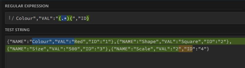

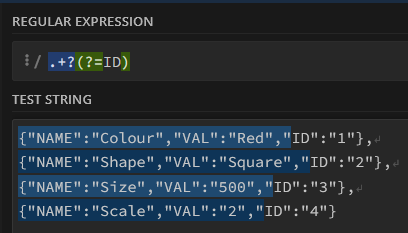

Use a regular expression testing website to get the bones of the regular expression. Then shoehorn the regular expression into the limitations of Airtable’s regular expression library.
Yah, good idea - although I struggle with then translating my solution back into the Airtables, such as this example where I’m removing ID":"#"},"
