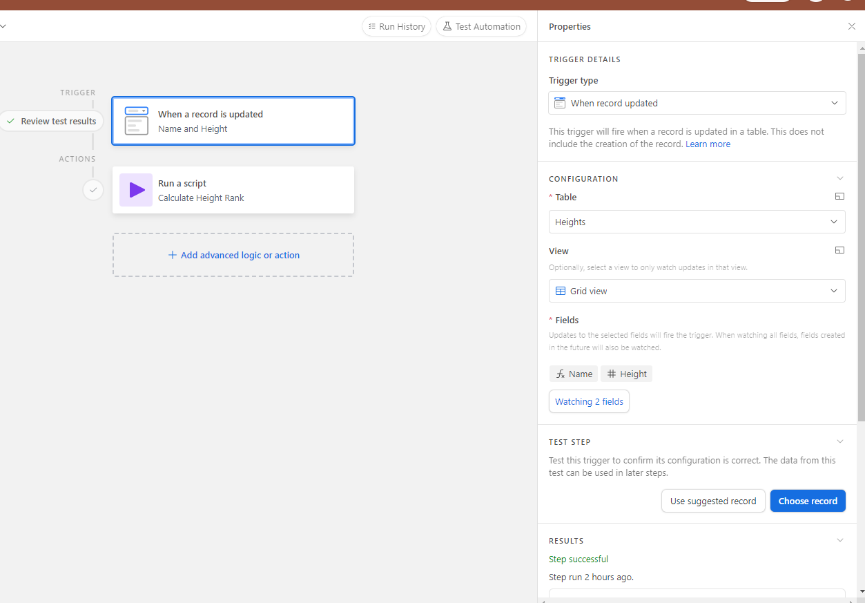

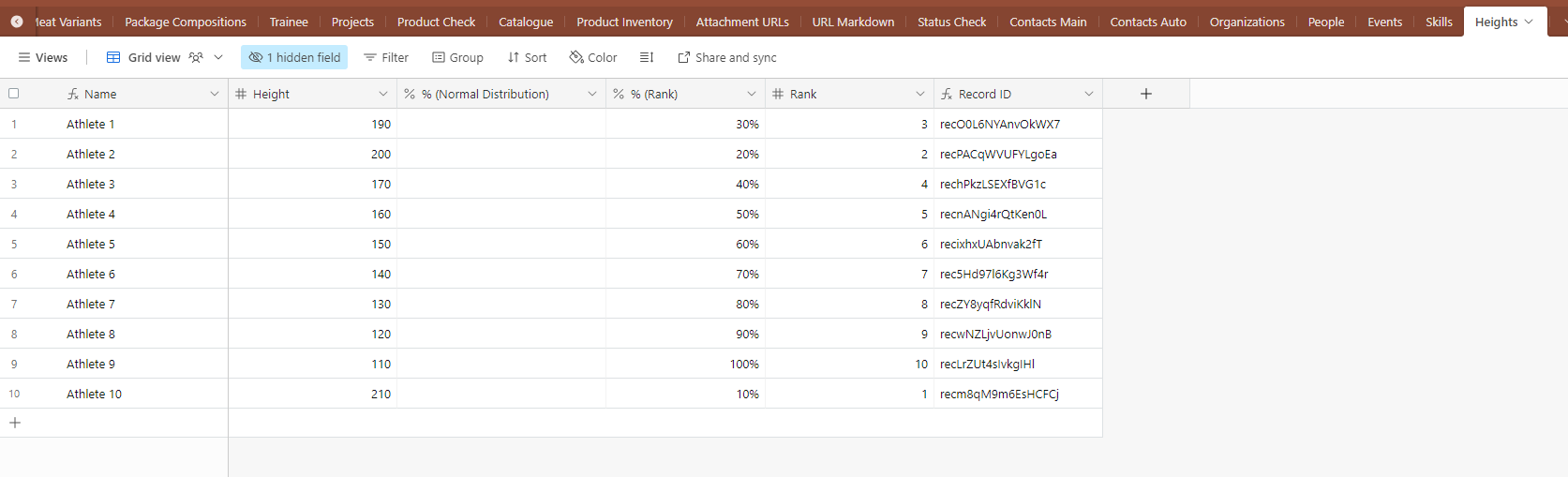

@russtanner6  @BillH  got some good news for you - had some time to crunch though this and came up with a simple automation you can implement. Here's a quick Loom Video to show you step by step exactly how it works.
Table setup and expected output:
Automation Setup:
Automation Script:
*** Remember to change all my table / field names to match yours to make this work ***
// Get Heights Table let athleteTable = base.getTable("Heights"); let atheleteQuery = await athleteTable.selectRecordsAsync({fields: ["Height", "Record ID"]}) let athleteRecords = atheleteQuery.records; console.log(athleteRecords) console.log(athleteRecords[0]) console.log(athleteRecords[0].getCellValue("Height")) let allAthleteHeights = []; let sortedAthleteHeights = []; for (let i = 0; i < athleteRecords.length; i++) { allAthleteHeights.push(athleteRecords[i].getCellValue("Height")) } console.log(allAthleteHeights) sortedAthleteHeights = allAthleteHeights.sort(function(a, b){return a- b}); console.log(sortedAthleteHeights) let count = 1; for (let j = sortedAthleteHeights.length; j >= 0; j--) { for (let k = 0; k < athleteRecords.length; k++) { if (sortedAthleteHeights[j] == athleteRecords[k].getCellValue("Height")) { var updates = [{ "id": athleteRecords[k].getCellValue("Record ID"), fields: { "Rank": count, "% (Rank)": (count / athleteRecords.length) } }] console.log(updates) await athleteTable.updateRecordsAsync(updates); count++; sortedAthleteHeights.pop() } } }
Let me know if this works for you!
