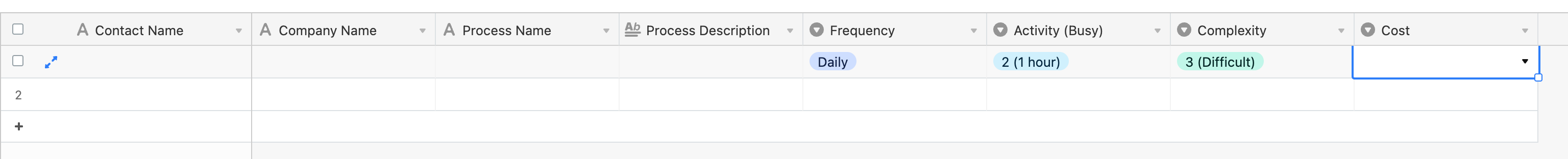

Hi
I would appreciate any assistance with my formula.
The end goal is that my Cost field should automatically calculate a cost based on a combination of options selected from the Frequency, Activity, and Complex fields.
The dropdown options for Frequency are:
  • Daily
  • 1 X Week
  • 2 X Week
  • 3 X Week
  • 1 X Month
"Daily" is equal to 22 days.
"1 X Week" is equal to 4 days.
"2 X Week" is equal to 8 days.
"3 X Week" is equal to 12 days.
"1 X Month" is equal to 1 day.
The dropdown options for Activity are:
  • 1
  • 2
  • 3
  • 4
  • 5
"1" is equal to 30 min.
"2" is equal to 1 hour.
"3" is equal to 2 hours.
"4" is equal to 3 hours.
"5" is equal to 4 hours.
The dropdown options for Complexity are:
  • 1 (Standard)
  • 2 (Medium)
  • 3 (Difficult)
  • 4 (Very Difficult)
"1 (Standard)" is equal to €15.
"2 (Medium)" is equal to €16.
"3 (Difficult)" is equal to €17.
"4 (Very Difficult)" is equal to €18.
Now in my Cost field, I want whatever I've selected in Frequency, Activity, and Complex to calculate as an amount.
For example, if I select "Daily" in the Frequency field, "2" in the Activity field, and "3 (Difficult)" in the Complexity field, the amount should be €374 (22*1*17).
I hope I make sense. 😎
Again, your help is appreciated.
Thanks

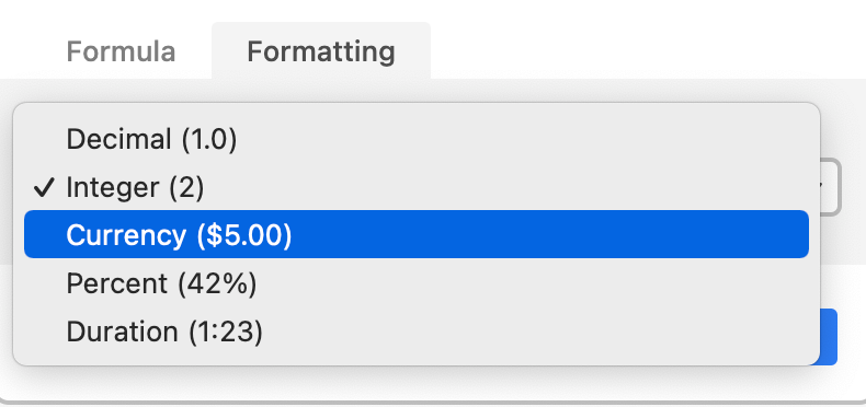

Once you have the Formula set, you can use the Formatting tab to specify Currency to correctly display the result, too.
