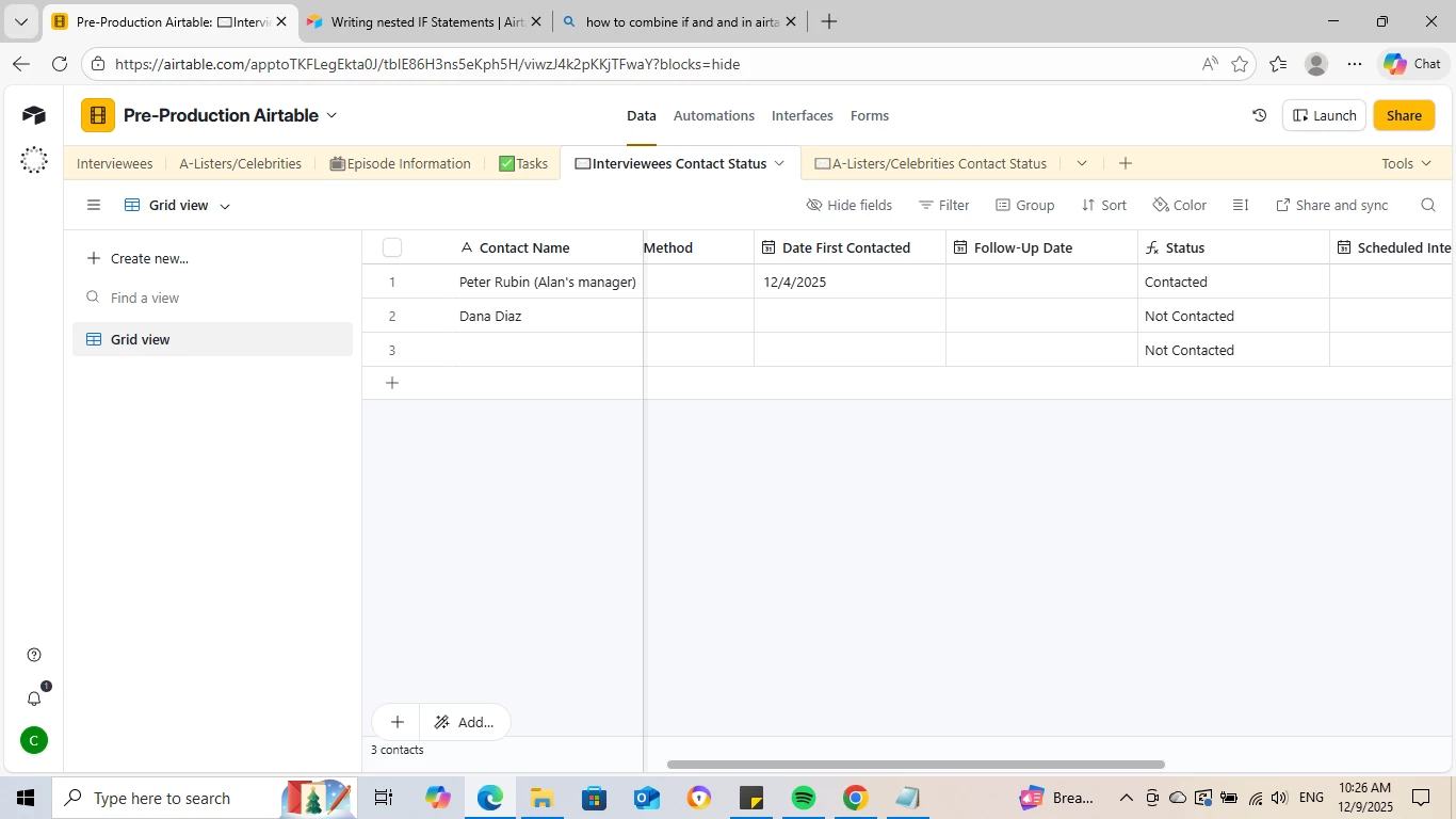

Hello everyone,
I am trying to make a nested IF/AND formula to do the following:
  • IF the ‘Date First Contacted’ = blank, status = ‘Not Contacted.”
  • IF the ‘Date First Contacted ‘= not blank and ‘Follow-Up Date’ = not blank, status = “Followed up.”
Is it possible to write this into a formula given that ‘Date First Contacted’ and ‘Follow-Up Date’ are separate fields?
Thank you!

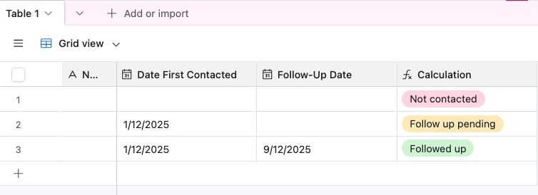

How does this look?
{Date First Contacted} = '',
'Not contacted',
{Follow-Up Date} = '',
'Follow up pending',
'Followed up'

Thank you, looks great!
