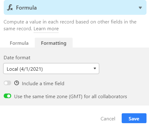

Hi Kristen. I was a little surprised at your question because I’ve never run across this limitation (which just means I probably hadn’t tried it yet). So I created a formula (simple DATEADD) that returned a date, though not yours (interesting as I’ve never tried *- together…does it work?)
Anyhoo. I think what you’re missing is that your formula returns a string. Won’t taking the DATETIME_FORMAT out work fine for you? The formatting tab in the formula field window should format the date you’re after by default.

Thank you! This demonstrates my underlying ignorance of the processes at work with functions. Appreciate your help and clear explanation!
