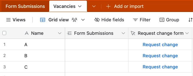

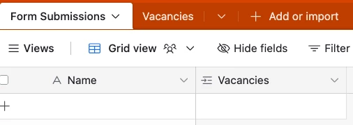

Hmm, I managed to get this to work but I'm not sure if our setup is the same?
Assuming your data looks like this:

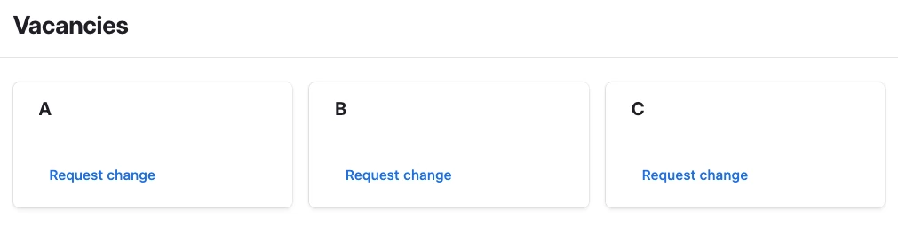

And your gallery looks like this:

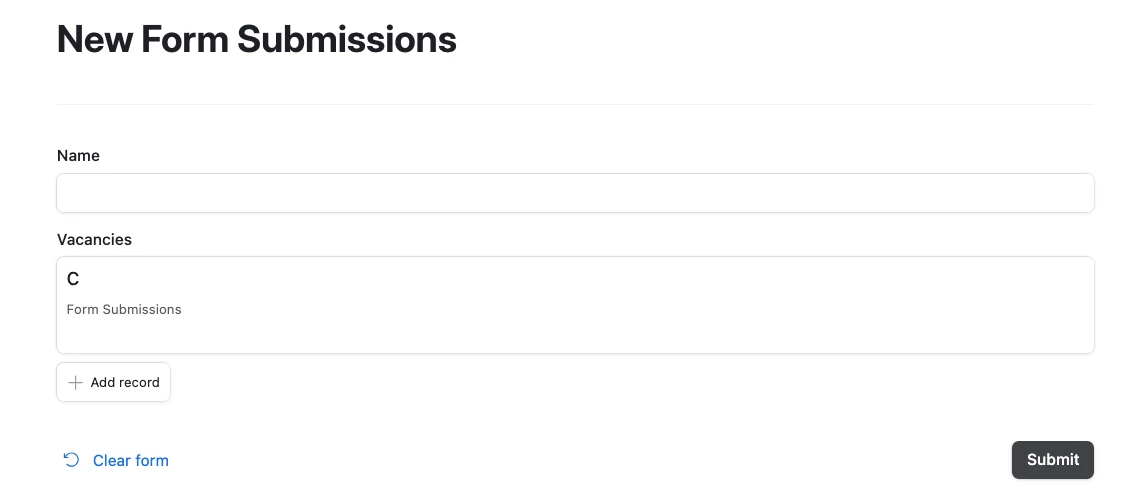

And you want the opened form to look like this with the Vacancies prefilled: 
Then this is the formula I ended up using, which looks the same as yours, really
'https://airtable.com/apppBA7UfjDul9W4z/pagfAPuU0opCeirkX/form?prefill_Vacancies=' & RECORD_ID()
