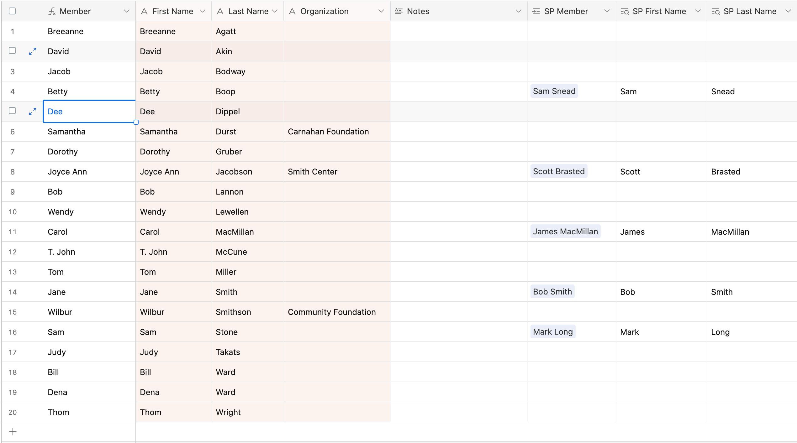

Hi, as a result of my trying to execute a solution from previous post, I created a formula to combine name fields. IT cannot figure out what aim doing wrong. IT seems perfectly logical to me. But it does not work. I have posted the formula and a screenshot of the data below.
The data is First Name, Last Name, SP First Name, SP Last Name. First Name and Last Name are short text fields. SP First Name and SP Last Name are Lookup fields.
Thanks, Scott

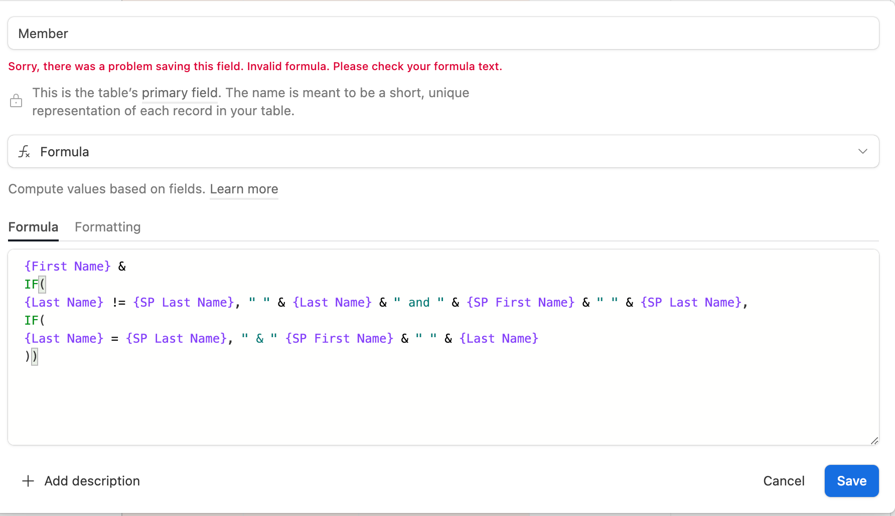

Hello and thanks. The formula still causes an error. Unfortunately, Airtable does not give you any clue as to what is wrong. So, I'm at a loss. The field names are correct and there are no red error marks in the formula itself. I just says it is an invalid formula. It seems tome this should be a straight forward formula.
I have posted a screenshot of the formula screen. Any help is appreciated. Best, Scott
Look at the colors to see where things have gone wrong. Look at the green ampersand within green quotes on the final line... that's where your problem is.
I didn't test your formula before... I was just correcting your parentheses. But now I have corrected your formula in my post above.

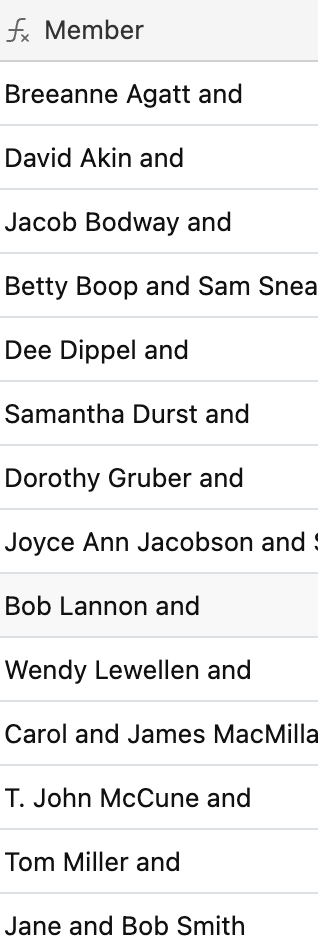

Ok, again thanks. The error are gone but one last issue. The formula is putting an AND after all the First Name Last Name Results.
Here is the formula as it stands now.
TRIM( {First Name} & IF( {Last Name} != {SP Last Name}, " " & {Last Name} & " and " & {SP First Name} & " " & {SP Last Name}, IF( {Last Name} = {SP Last Name}, " and " & {SP First Name} & " " & {Last Name}, IF(NOT({SP First Name}), " " & {Last Name} ))) )
Screenshot of results:
Another problem is that you can't compare text fields to lookup fields (which are not text fields but are arrays).
You can only compare fields that are the exact same field type.
So at the beginning of each IF() statement, you need to convert any lookup fields to text by changing any references to lookup fields to:
{Lookup Field} & ""
