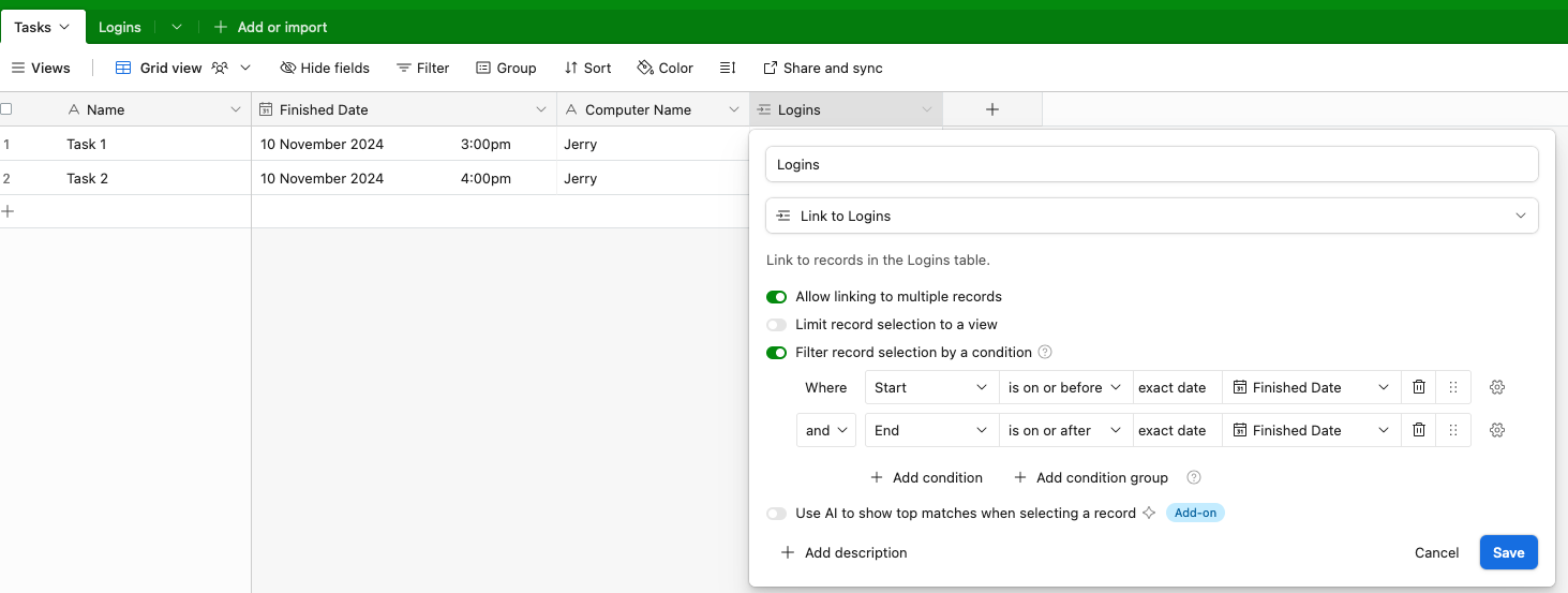

Ah, yeah this is a tricky one and it's not possible to do this with a formula alone
The easiest option involves you doing a manual step for each task, specifically, linking the records together.  You'd use dynamic filtering (https://support.airtable.com/docs/dynamic-filtering-in-linked-record-fields) to create the linked field and make it only show the logins that are in range of the start and end time of the task:

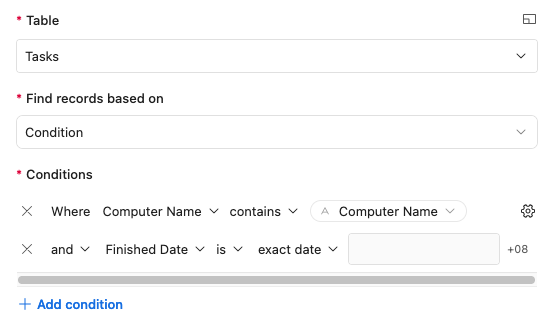

If you want this fully automated, the easiest option would be to use a script for it, as Airtable doesn't allow us to do a Find Record on a dynamic date at this time I'm afraid:

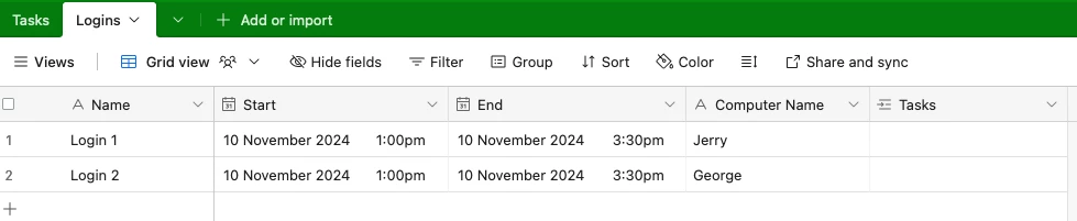

And if scripting isn't an option, you could try to build an automation system to:
1. Link all your tasks to a single login when the Login record is created
2. Use lookups to pull the data over to the Tasks table
3. Use formula fields to determine which tasks fall into that Login
4. Have the automation find the records that are relevant based on those formula fields and link it to the triggering Login record
