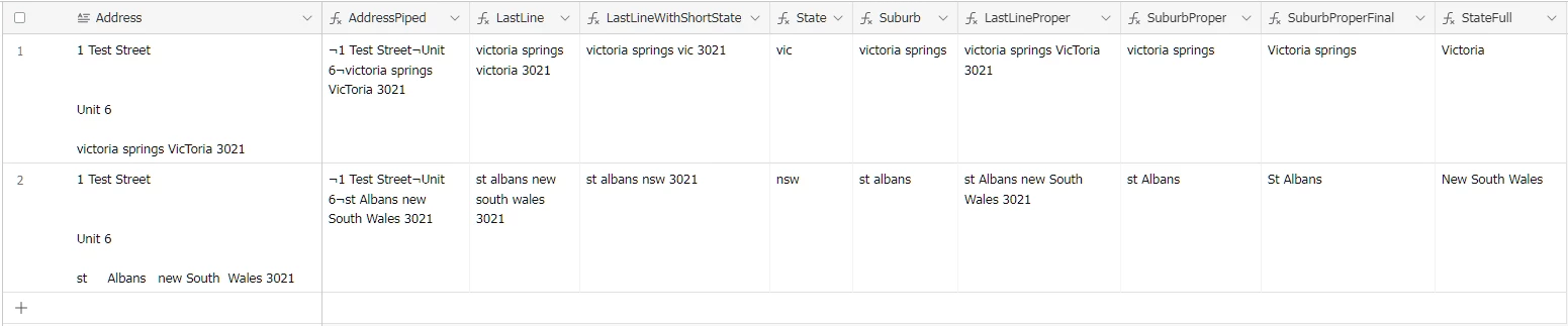

Here is a solution that extracts suburb and state, allowing for extra line breaks, spaces and differing capitalis ation:
AddressPiped: "¬" & REGEX_REPLACE(REGEX_REPLACE(Address,"[\n\\r]+", "¬"), " +", " ")
LastLine: LOWER(REGEX_EXTRACT(AddressPiped,"¬([^¬]+)$"))
LastLineWithShortState: REGEX_REPLACE(REGEX_REPLACE(LastLine, "victoria ([0-9]{4})", "vic $1"),"new south wales ([0-9]{4})","nsw $1")
State: REGEX_EXTRACT(LastLineWithShortState," (nsw|vic) [0-9]{4}")
Suburb: REGEX_EXTRACT(LastLineWithShortState,"^(.+) " & State & " [0-9]{4}")
LastLineProper: REGEX_EXTRACT(AddressPiped,"¬([^¬]+)$")
SuburbProper: LEFT(LastLineProper, LEN(Suburb))
SuburbProperFinal: UPPER(LEFT(SuburbProper,1)) & MID(SuburbProper,2,300)
StateFull: SWITCH(State,"nsw","New South Wales", "vic", "Victoria")
I've only done this for new south wales and victoria so far, the fields LastLineWithShortState, State and StateFull need finishing with the other states.

I'll try again:
Here is a solution that extracts suburb and state, allowing for extra line breaks/spaces, and differing spelling of state and capitalisation (and also if the state name is in the suburb!):
SuburbProperFinal: UPPER(LEFT(SuburbProper,1)) & MID(SuburbProper,2, 300)
The fields LastLineWithShortState, State and StateFull need finishing off with the other states.
