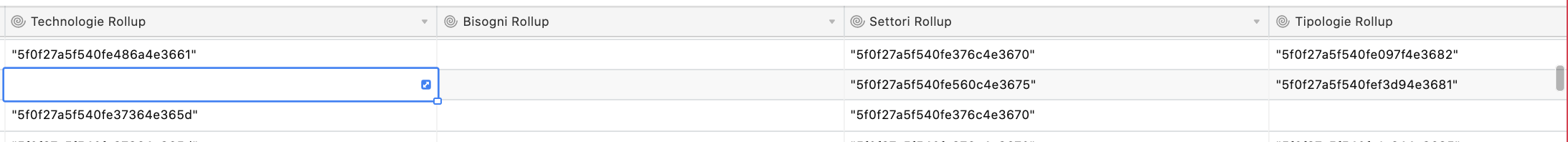

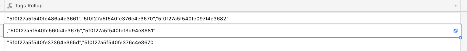

Thanks for the help so far Justin, great advice on the formatting.
However the solution to the primary problem, just creates the reverse issue sadly,
now if the Technologie field is blank and the Bisogni has a value for example this creates a comma that I don’t want at the start of the string instead of the problem before where it would be at the end.
Don’t worry too much about the ID numbers specifically mean below but basically you can see how the row thats missing an ID number for Technologie creates the issue in the screenshots below. Which is a problem as when I then use this data in Zapier I have problems with validation because of the additional commas :frowning:
