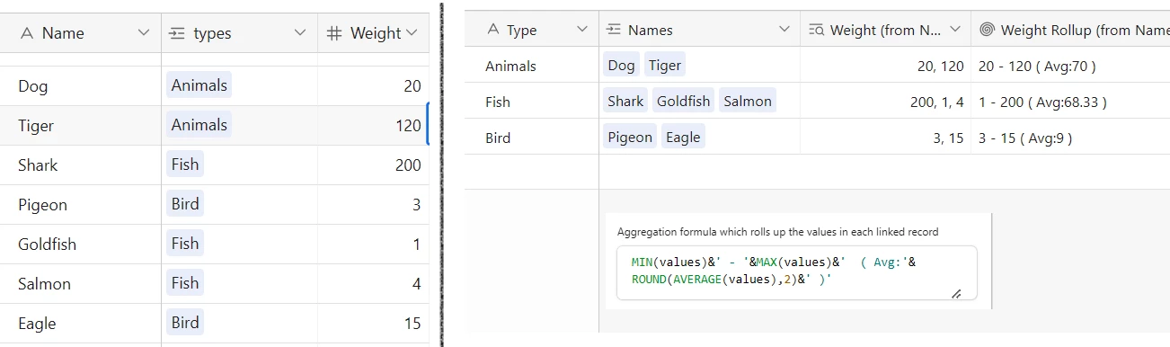

Usually, when you need such type of summary, you should create formula field in your basic table (like you did YYYY-M). Then create linked field to a new empty table and copy-paste whole formula column into that linked field. Such bulk-linking works like:
 find this value in a primary field of linked table and link to it. if not found, create such record and link.
 thus, you will get the unique list of YYYY-M in other table.
The only thing to care about is - when you have new record, and fill date so the YYYY-M has its value, it must be linked. Often it’s done by automation
a kind of short explanation about lookup & rollup. these field types and ‘count’ type as well, are computed, and must be ‘based’ on some linked field:
