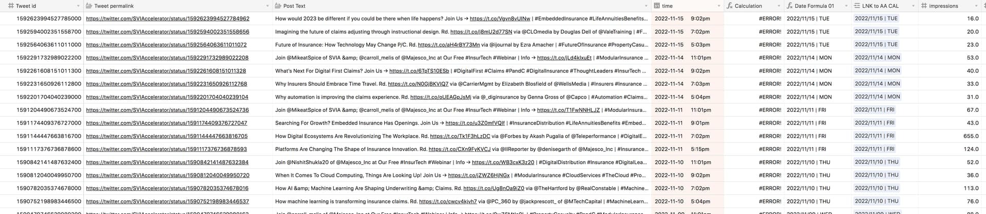

Hello.
Looking for a formula that allows me to both convert to central time & round to nearest hour.
What I have
2022-11-11 4:01pm
2022-11-11 2:01pm
2022-11-11 12:02pm
2022-11-11 10:15am
Want
2022-11-11 4:00pm
2022-11-11 2:00pm
2022-11-11 12:00pm
2022-11-11 10:00am

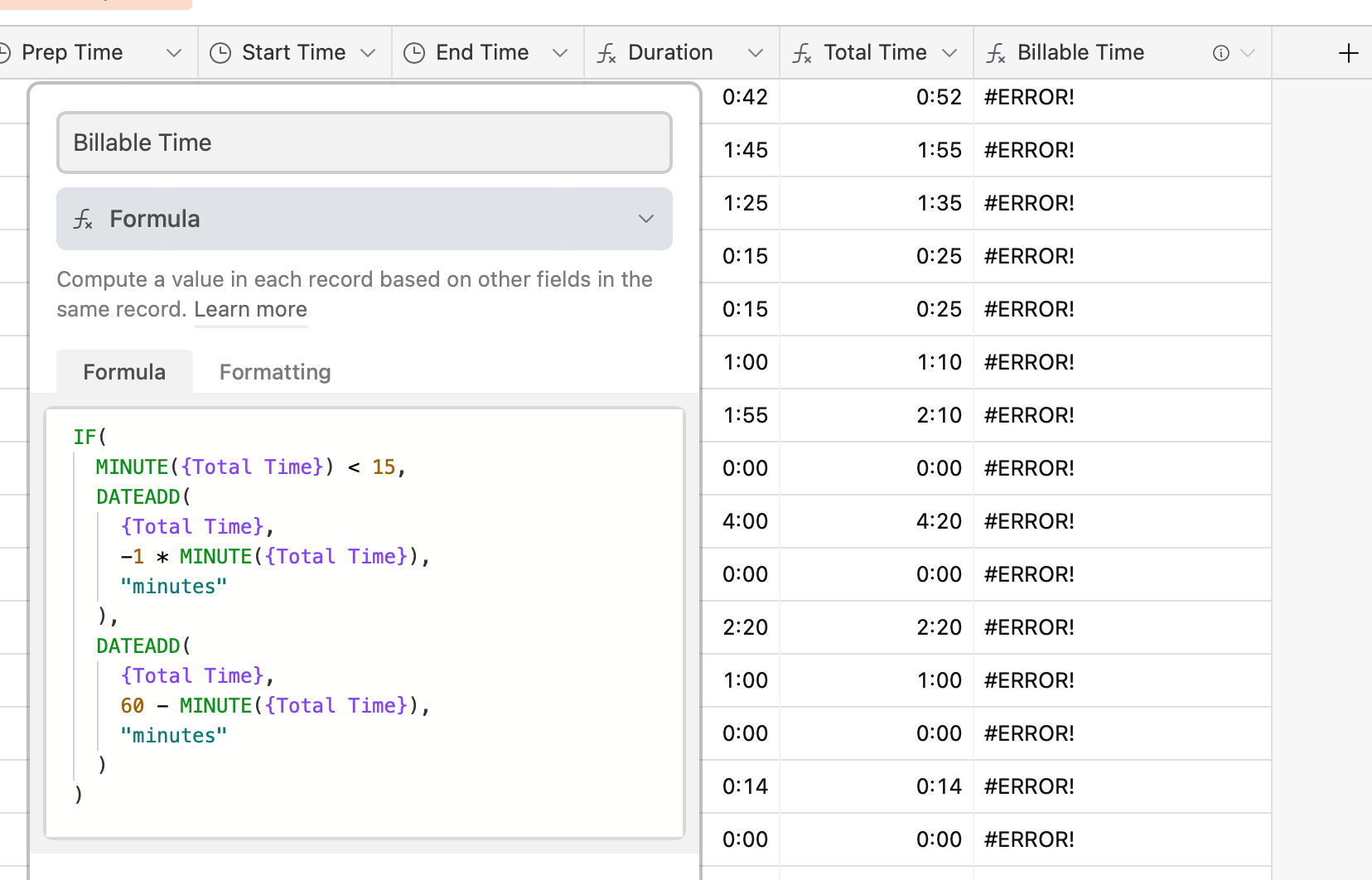

I'm trying to do the exact same thing and it isn't working... Help?
The total time is = Prep Time + (End Time - Start Time)
I want to ROUNDUP the total time to the nearest quarter hour and was trying this formula to the nearest half hour and it doesn't work.
