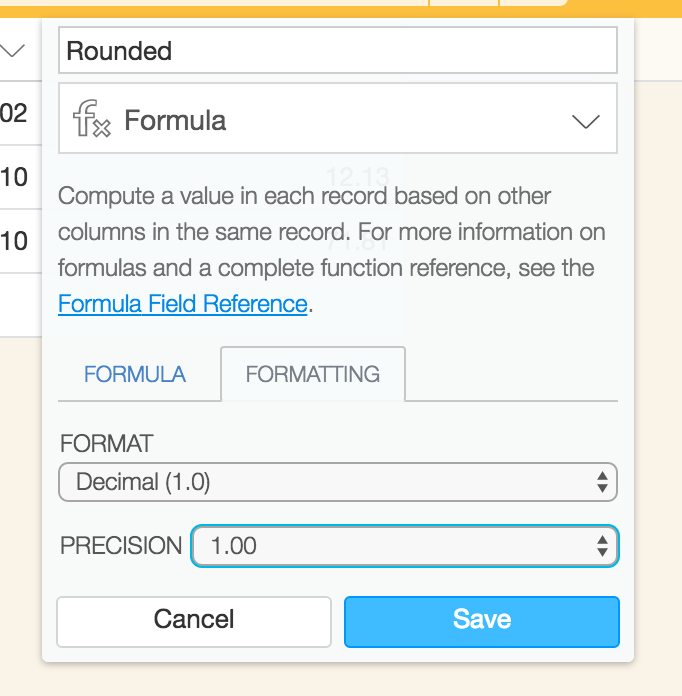

A simpler solution might be use a formula like this:
ROUND(Amount + 0.00499, 2)
@Izaac_Post when using the ROUND formula, you have to also make sure to update the “Formatting” of the of formula so it displays the correct precision:
Forum|alt.badge.img+7
  • August 7, 2016
That would be a much better solution! Thanks for sharing, that will save me time in the future too!
