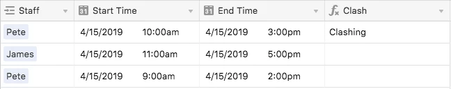

The solution below will only work when creating a new shift record for a given staff member, and comparing that shift’s start time against the rest for that staff member, which is what it sounds like you want. The other caveat is that it won’t (and can’t) put the clashing indicator on the new record, but rather on any shift record that it clashes with. Here’s how it looks in my test:
The latest shift start time for Pete falls in the middle of his first shift, so that first shift is tagged as clashing.

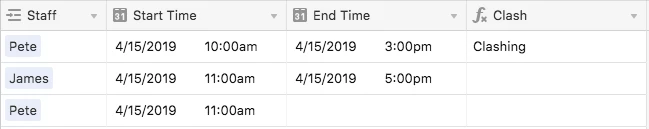

I’ve put this in my base and had a play around with it - it appears to work well when allocating shifts in chronological order.
However, if we’re putting someone on a shift before the time they’re already working and the end time causes the clash, it doesn’t flag it - which I know is different to what I was originally looking for.

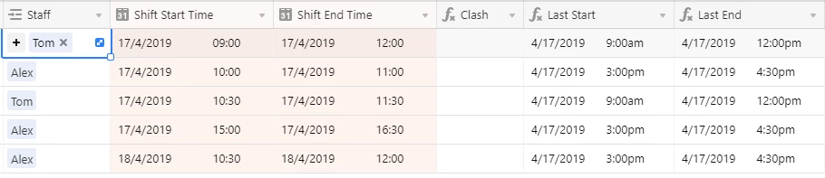

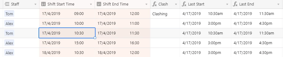

The order we assign the shifts seems to be primarily important here.
If we schedule chronologically, Tom’s 10:30 shift causes a clash with his 9:00, as it should, since the both the start and end time are within the earlier shift.
If we schedule him on the 10:30 and then the 9:00 (or even replace him on the clashing shift with himself), it won’t flag the clash, since neither the start nor end time are within the 10:30 shift, but the time inbetween is.
All I can think of is to add some conditions to the formula to check if other times between the start and end cause clashes too, but I’m hoping there’s some hidden logic to this puzzle that that will avoid having to brute force the IF formulas.
