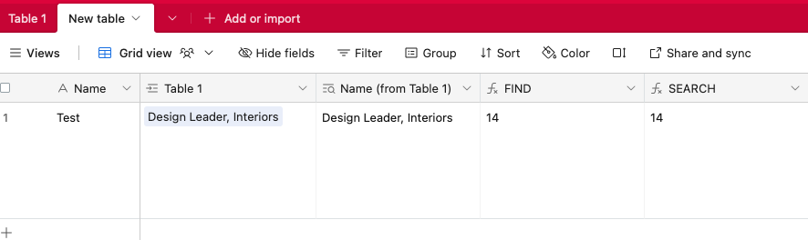

As a datapoint, @Mike_AutomaticN 's solution works for both FIND and SEARCH:

Lookup is always array. Even when it has 1 or 0 elements. [1,2,3] or [1] or []  - are arrays.
Usually solution is quite simple, I use CONCATENATE({Field})  or ""&{Field}
I think ARRAYJOIN({Field}) should do the same
