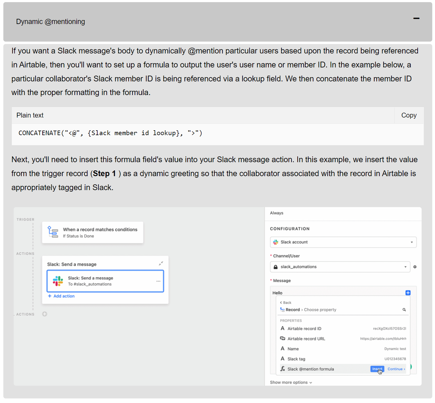

3. Dynamic @mentioning
CONCATENATE("<@", {Slack member id lookup}, ">")
All of these methods worked when I linked only one record, but when I linked multiple records, they didn't work correctly.

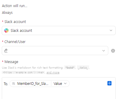

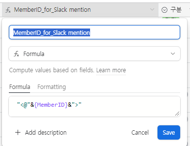

Thanks to your advice, I have solved the problem.
I solved the problem in the following way
1. record each user's memberID in the form "<@{memberID}>" per record in the user information table
2. in the other table, add a CC field link to the user information table
3. add the user's memberID as a lookup field
4. trigger mentions via the memberID lookup field in Slack Notification Automation
Thanks for your help.
