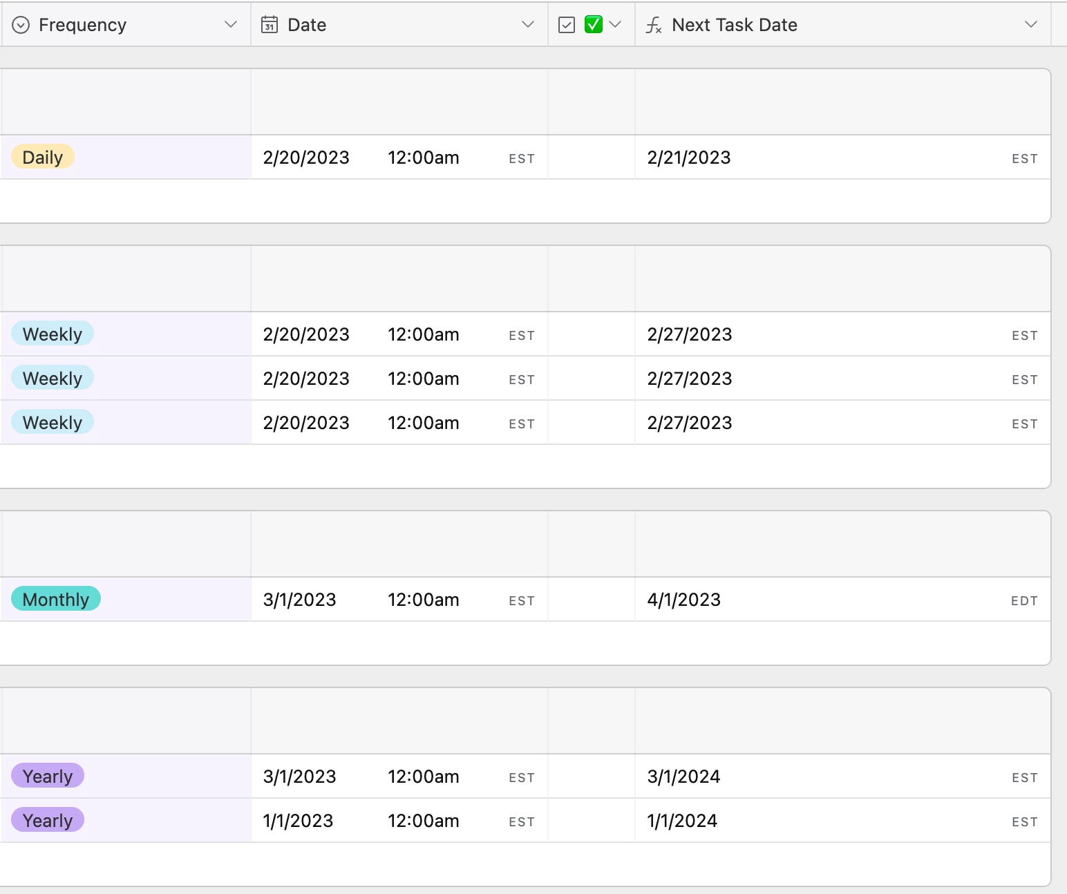

I'm having issues with Airtable's default GMT timezone. I have a Date field (which I do not want to have time displayed for) as well as a formula field using the DATEADD formula to calculate the next time a task is due, based on frequency.
In the formula field, I can specify timezone. In the Date field, I can't - without adding the time. Because of that, it's calculating incorrectly - everything is off by a day. Only when I add a time do the dates show up correctly.
Is there any way to fix this? Do I need to add something to my DATEADD formula?

Thank you for your response! Is there any way to make them both appear in EST?
