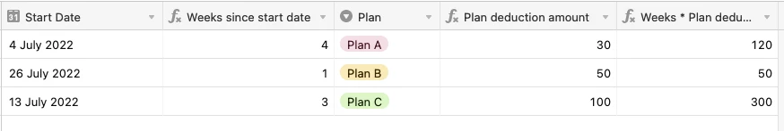

Hmm, not too sure I follow what your end goal is, but I’ve put something together here that I think answers your latest question about adding the weekly values together
If you could manually create a table that shows some example data of how you would like your data to show up in an ideal scenario I could provide suggestions on how to achieve that?

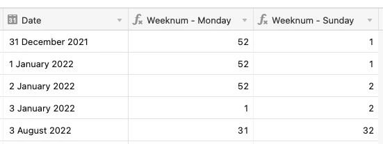

I appreciate this. I was actually able to sort out this need by using the SWITCH command. One thing I am having trouble with in week numbers is the WEEKNUM command is returning the wrong week. IT says the week is the 32nd week, but we are in the 31st week of the year.
I am using
WEEKNUM(TODAY(), “Sunday”)
I tried adding the SET_TIMEZONE parameter to the formula, but it didn’t change anything. Maybe my syntax was bad because I am not quite sure how to combine the two functions together.
I am using
Hmm! When you say it’s the 31st week of the year, what day does that start on?
As you can see from the screenshot below, if it starts on Monday, it’d be the 31st week, but as you’ve set the start day to be Sunday, it’s week 32 instead
