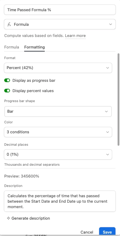

I am currently having an issue with a formula that I am trying to show as a progress bar. Here are the specifics:
I am calculating the percetage of time passed between a start date and an end date. The formula seems to be correct:
ROUND((DATETIME_DIFF(NOW(), {Start Date}, 'days') / DATETIME_DIFF({End Date}, {Start Date}, 'days')) * 100, 2)
However, when I go into the "Formatting" section of the Formula Field, it gives me a very large percentage which seems to be incorrect (in this particular case the preview shows 345600% but in the formula section, the preview shows 35.56%. I have attached the two images of the settings below:
Please can someone help me? xx
Try removing the *100:
ROUND((DATETIME_DIFF(NOW(), {Start Date}, 'days') / DATETIME_DIFF({End Date}, {Start Date}, 'days')), 2)
If you're displaying it as a bar you can try removing the ROUND too as there isn't much of a difference visually I reckon

Hello @MegKrashCourse
You've done nothing wrong here. The formula is correct but airtable just used a different approach(nature) to handle the formula field.
Go to this official help page https://support.airtable.com/docs/number-based-fields-in-airtable#percent-fields
Read this and more.
The percentage field type hosts numerical values formatted as percentages. The values in a percent field are shown as fractions of 100 with the percent symbol. For example, .75 in a percent field is represented as 75%.

Oh my gosh! You're amazing! Thank you so much!
