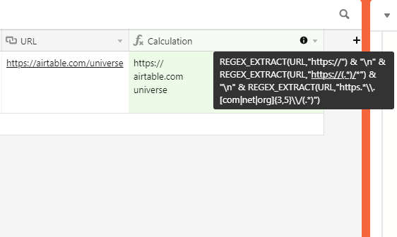

I want to be able to split a url address into its component and use them as I may need.
What I have:
“Airtable Universe”
What I’d like to achieve
“https://”
“airtable.com”
universe
how would you handle this use-case?
can you provide any smart solutions?
thanks in advance
Best answer by Paolo_Perrone
If I’m understanding you correctly, this regex will do the job here:
REGEX_EXTRACT(URL,"https://") & "\n" & REGEX_EXTRACT(URL,"https://(.*)/") & "\n" & REGEX_EXTRACT(URL,"https.*\\.[com|net|org]{3,5}\\/(.*)")
If you want to match the final slash in the address, just push the \/ construct into the parantheses-bound capture group at the end. The regex itself is a bit hacky but I’ll chalk that up as a plus in case you wanted to improve upon it and learn a few things yourself. :grinning_face_with_sweat:

the quotation marks are there to show the web address without previewing it
if I copy the address w/o quotes we get a preview like this
however the link I want to parse is in a url field
