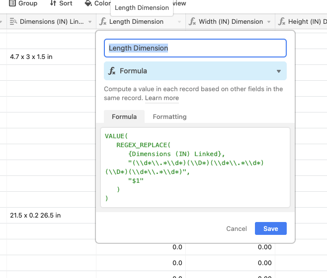

Do you have any guesses as to why this error is happening? I’m wondering if because there are decimals and not an integer?
The formula is written to handle decimals. Since you’re pulling from a Lookup-type field its possible Airtable is reading {Dimensions (IN) Linked} as an array and not a string. In the formula, change: {Dimensions (IN) Linked} to {Dimensions (IN) Linked}&"".

One more question for you:
VALUE(
REGEX_REPLACE(
Name,
“(\d*\.\d)(\D*)(\d*\.\d)(\D*)(\d*\.\d)”,

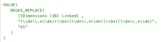

In the “Name” section, is this where I would put the column name I am pulling from? I’m guessing no based on this formula I attempted:
Any guidance on how to appropriately pull from that column is appreciated.

Never mind! THere was a rough [ which was causing the problem. Thank you for your help!
  • September 23, 2021
YES thank you! That did the trick!
