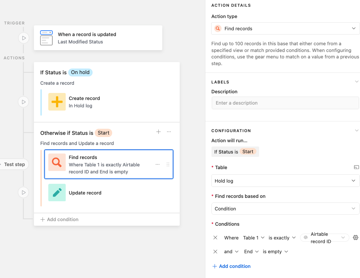

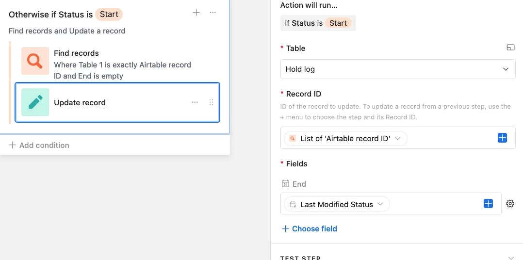

@TheTimeSavingCo  - So the ticket can go into an "on hold" status multiple times. I've managed to create a new record in a separate table with the date the on hold was created, each time the "on hold" status was chosen. However, I am struggling to figure out how to associate the "on hold end date" field with the same record, when the status changes from "on hold" to something else?
I would need this to calculate the number of days each time the ticket was on hold. Unless I am missing something?
Try to look for a record that's linked to the triggering record that has no end date?

This was perfect, exactly what I needed! Thanks!!
